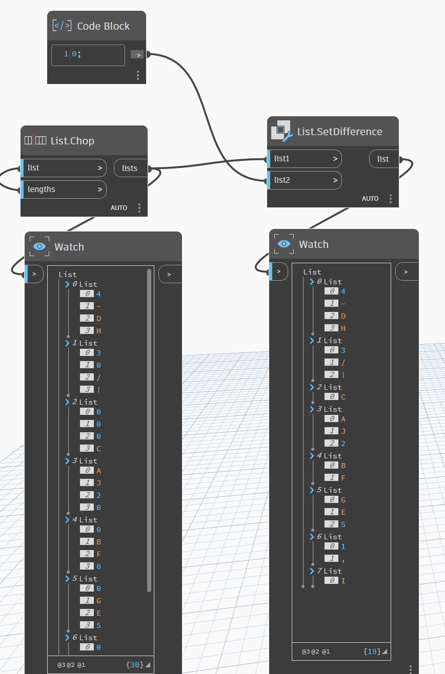

I have a question about list manipulation in Civil3D Dynamo.
As shown in the attached image, I have a list that contains the value 0.
I would like to create a new list by removing the entries that contain 0. Is there a good way to do this?

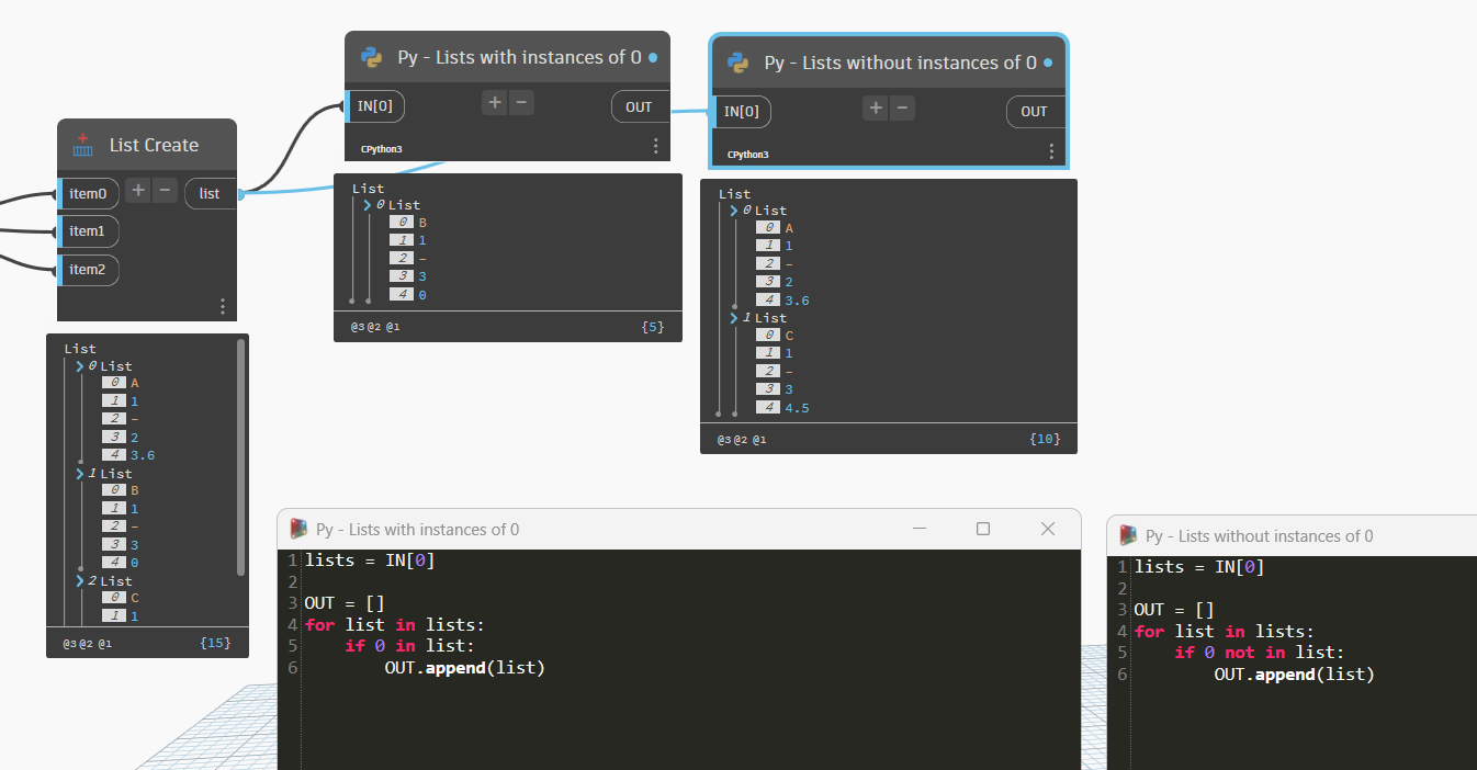

Here is a small piece of Python logic to try if you like.
To return lists which contain 0
lists = IN[0]
OUT = []
forlistin lists:
if0in list:
OUT.append(list)
To return lists which dont contain 0
lists = IN[0]
OUT = []
forlistin lists:
if0not inlist:
OUT.append(list)

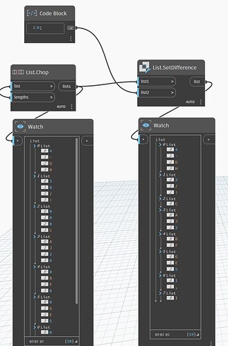

Hola amigo @shirai-a buenas. the easyest way to perform is to use List.SetDiference, I hope this helps you!!
