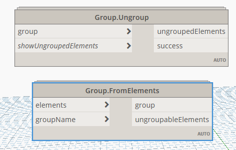

Clockwork has two nodes that will give you what you are looking for

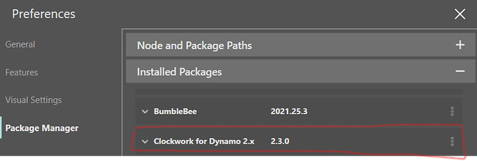

Hi @staylor thanks for your response. But I am not able to find that node in the clockwork. What version of package are you using?

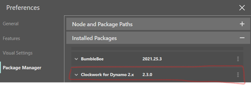

I am using the following package version.
@shashank.baganeACM
Weird! That’s the version I have loaded also. When searching make sure to type the names in exactly with the periods and no spaces. The search is very picky about that. Group.FromElements and Group.Ungroup. If you still can’t find them, you may need to uninstall and reinstall the package.

Hi @shashank.baganeACM dont looks like the newest clockwork its 2.4 ? do you have Bakery installed ?
Hi Samuel looks like he is in 2023 and you are lower thats why we need 2.4 i guess ,)

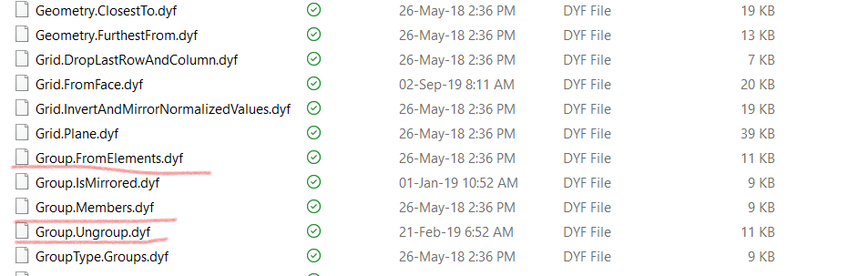

Yes @sovitek bakery installed in the system. May be due to that it is getting conflicted.
Even I have those nodes on the 2.3 version also.
But I am unable to use see them in the canvas. Do I have any options other than uninstalling bakery package ?
Hi @shashank.baganeACM …im afraid thats the option…do you use bakery a lot ?
