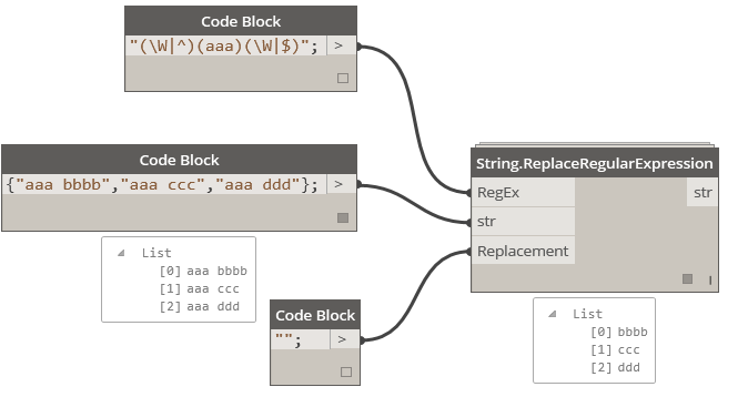

Hi Danny, no, there’s only a StringReplace node which works fine for simple cases of search/replace, but not for any rule-based stuff. You can however use Python for working with RegExp. About a year ago, I made a Python-based custom node to match regular expressions in a string. I have now added a couple more such nodes (replace regexp, split by regexp, …) to package Clockwork. Enjoy.
Clockwork has String.ReplaceRegularExpression . Example:

I downloaded the Clockwork package. I couldn’t replicate the example you had. I looked for a document or an email from anyone who might have worked on the Clockwork regular expression without any luck. Do you know what I need to set this up or what I might be doing wrong? The str return gives me a empty string.
I was able to replicate it based off of yours Danny. I uploaded mine that works see if you are still having the issue. regular expression
It looks identical. I’ve found that often I have to unplug a node, run, re-plug, run again to get Dynamo to work.
I read that it’s some kind of some caching buglet.
