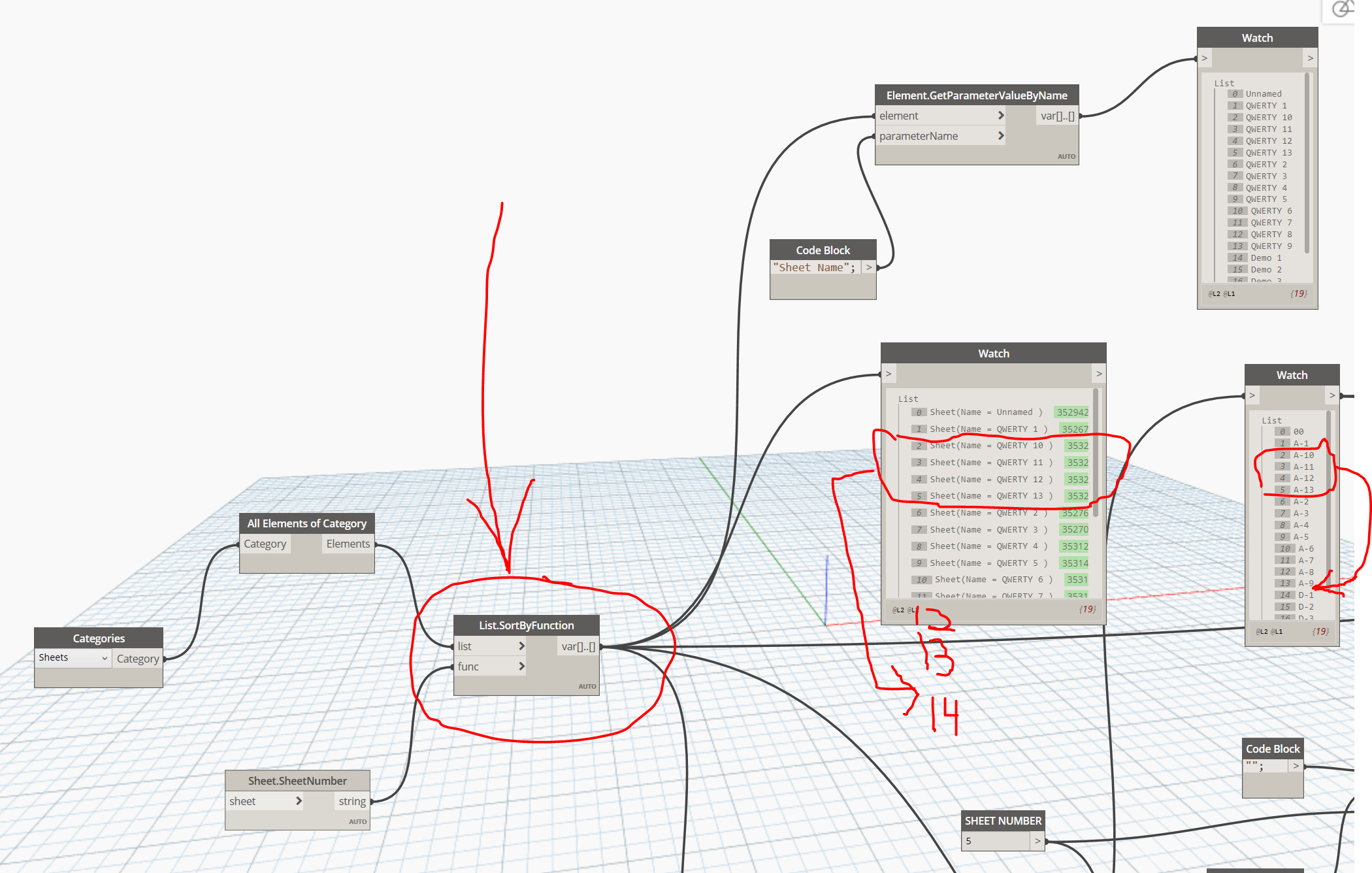

So I used List.SortByFunction and managed to successfully sort a list of sheet instances by name. Only problem it sorts them as a string, so sheets A-10 through A-19 between sheets A-1 and A-2. This kind of cornered me in, because need the actual sheet instances to be arranged in that list, so I can make modifications to those sheets later on.

at index 16 and 17 you can see they are on the right place. (not directly underneath index 11)
This gave me same result as List.SortByKeyFunction. Im pretty sure if I change A-1, A-2, A-3 to A-01, A-02, and A-03 I would get the result I need, but our office omits the 0. Any other ideas?
