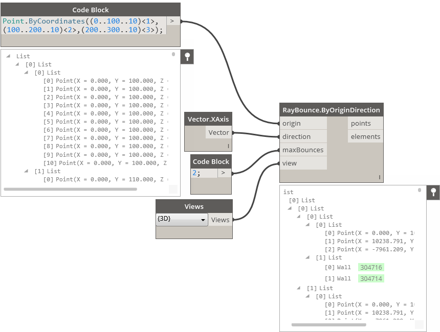

Has anyone been able to use the RayBounce node to iterate through multiple analysis/origin points (using the loop while node for example)? Or does anyone know if or how you can access this class in Python??
20151229-1

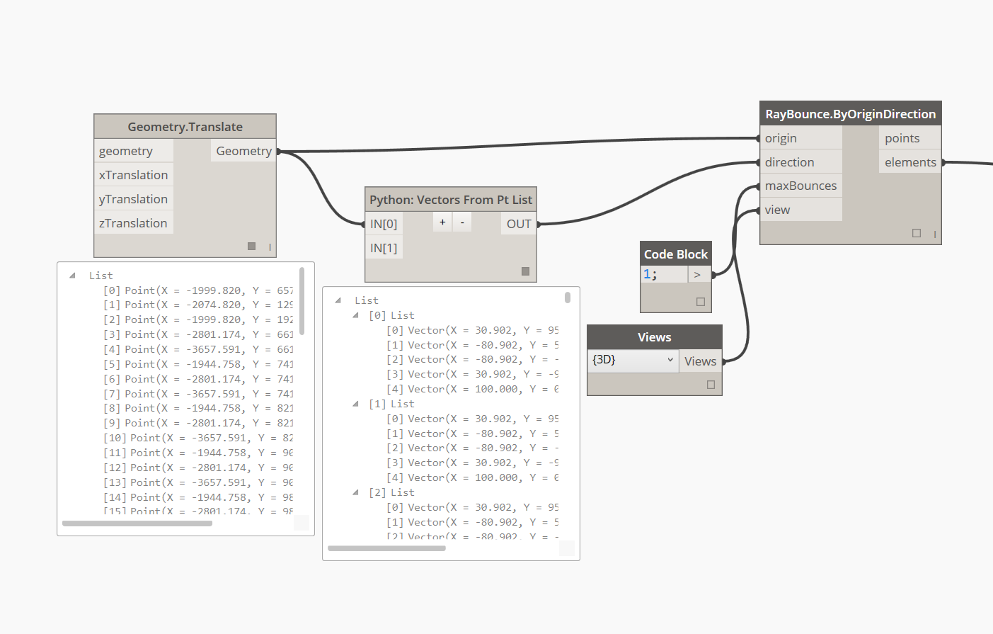

I would like to run the RayBounce across multiple points, where each point has multiple direction vectors.
Capture0114
Use Replication Guides with the Design Script equivalent of the node
Thanks again. I actually found a way to do the RayBounce analysis in Python using the ‘ReferenceIntersector’ class.
