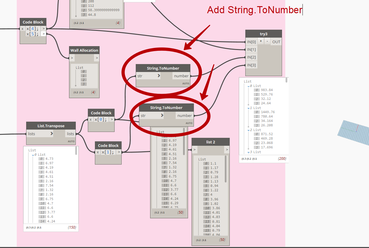

@JuliaKaltenegger Currently you where feeding string values. Just add String.ToNumber node and you will be good to go. Cheers!
Oh jezz, so easy. i didn´t expect that my lists were strings. thanks so much.
