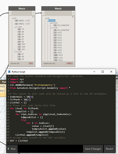

I’m looking to map information from a dataframe, in Revit 2020, as CPython3 is not available, I can’t use pandas so I have to do it old-school

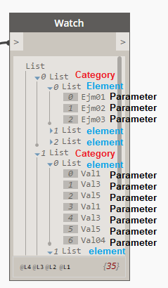

The objective is to obtain the indices of a list with depth 4, (List of Elements by category with List of Parameters with Sublist Values) vs List of Elements of category with List of Elements) .
The detail is that the mapping is done by brute force and I cannot unstructured the list to reduce the complexity, so although some elements are not contained within the list of the parameters I have to pass it to avoid a value placement error.
The clearest example would be seen here, I have to pass the empty lists of elements within the comments list, and then continue through list two that if it has elements.
IndexVals = IN[0]
TLFParN = IN[1]
ListVal = []
# Place your code below this line
for LSval in TLFParN:
	templist = []
	for LVal,indices in zip(LSval,IndexVals):
		tempsublist = []
		try:
			for i in indices:
				value = LSval[i]
				tempsublist.append(value)
			templist.append(tempsublist)
	ListVal.append(templist)
OUT = ListVal
Here I left one script with the example prExample-Question.dyn (10.6 KB)
oposed

Hi @Luiscko,
I read your case, but I cannot figure out what you are trying to do here. I have checked your example file and this too doesn’t make it clear. What are you trying to do with these 2 array’s in the example file?
you first list is a list containing “List of Elements by category with List of Parameters”?
000193
your second list contains what, Indices of some sort?
000194
Could you some how show what the end result should be or explain it a bit more?
Sure
The result for this case will be:
List
 List 0
	List 0
		0 Empty List
	List 1
		0 Val1
		1 Val5
	List 2
		0 Temp1
		1 Temp1
 List 1
	List 0
		0 Empty List
	List 1
		0 Temp1
		1 Temp5
	List 2
		0 Ejem01
		1 Ejem04
@Luiscko
