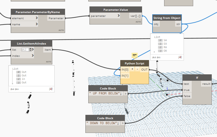

Hi. I have 2 lists as inputs to a Python Script node in dynamo. The first list is a list of duct connector orientations (“in” or “out”). The second list is a list of the system abbreviation that the connector is a part of (“SA”, “RA”, “EA”, or “OA”)
.I need a python script that compares the item at Index[1] from input 1 against index[1] from input 2, but I’m having a hard time figuring it out. Here’s what I have. It tells me line 15 (the ‘if’ statement) is wrong - traceback error - but I have no clue how to rewrite it.
Any help would be greatly appreciated!
