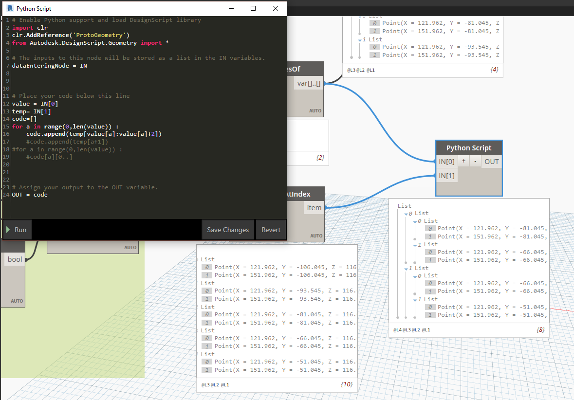

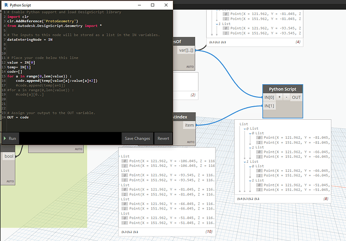

I am trying to understand how to write data to lists using python code.
In my example shown below:

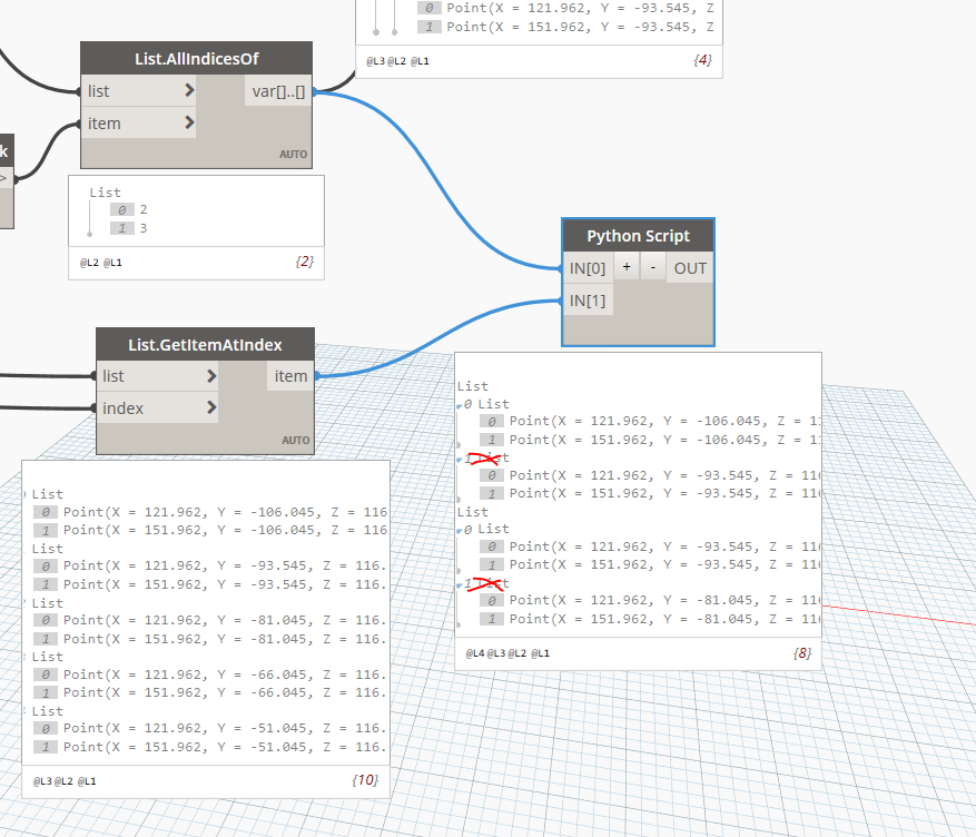

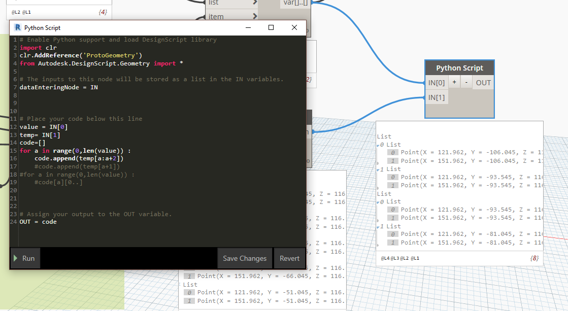

I would love to be able to have (2) lists created, with (4) points in each sublist (current output has data structured within too many list levels). I know I could easily utilize the flatten command using levels, but there has to be a way to do this in the python script as well, right?
let’s also ignore the fact that I am pulling the wrong indices:
now pulling the correct data :grinning:, question still remains though

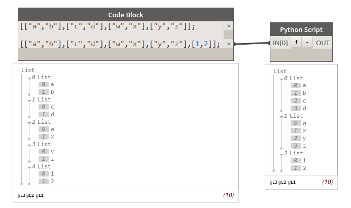

It is hard to tell what the input list structure is like and what you want the output structure to be.
Is this what you mean?
That is what I desired. Sorry away from the computer now for the night or else I would give a better screen shot.
