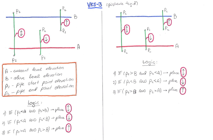

I am tring to filter standpipes according to Pipe start and end points relation to current level (Picture1)

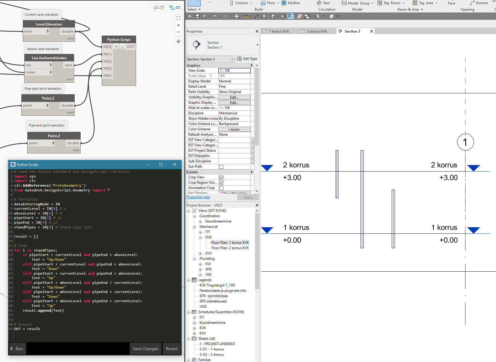

I am planning to use Python node to make this filter work (Picture2)
Node works without issues, but it assigns the first element result to ALL elements of the list.
I thin kthere is some Python tip i have no clue about.
Your ‘for’ statement is iterating through standPipes…which is really doing nothing.
You need to iterate through pipeStart and pipeEnd with a zip function (parallel iteration)

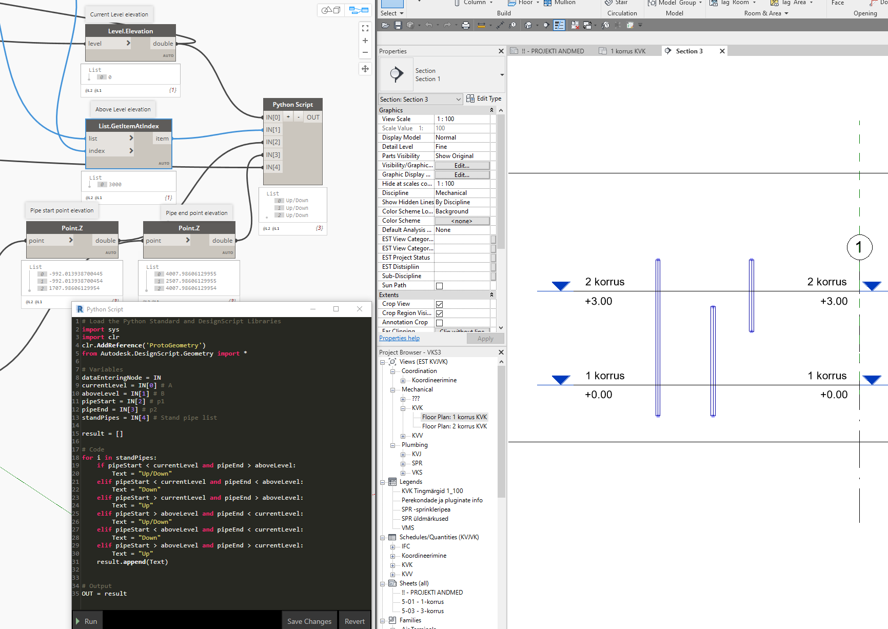

I investgated what this zip() function is and tried to implement it.
But i still dont have correct result (Picture 1)
It works on my side. Can you maybe check the levels of “levels”? or add CurrentLevel[0] instead of CurrentLevel?
