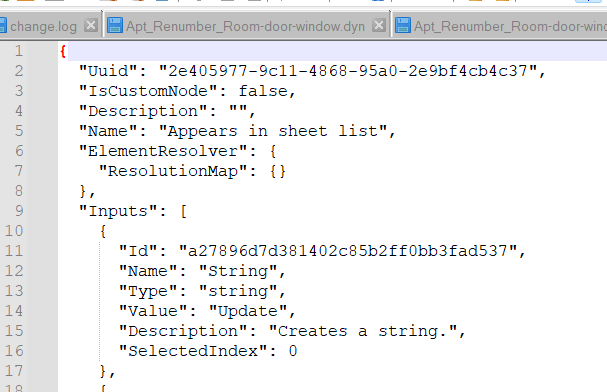

Hi Jacob, how do you tell what packages are from 1.3 dynamo?
They’ll be in XML format instead of JSON.
The easiest way is to check the first character. I can’t recall the markers exactly, but if you check the first line of a Dynamo 1.x graph and the first line of a Dynamo 2.x graph in a text editor and it should be clear.
So the packages in the graph dictate if itll be XML or JSON? So if I remove the 1.X and close the graph and open again, itll revert to JSON? I cant find what your saying the first line of a graph sorry. Happy Birthday BTW if it is! Also just thinking all my graphs got read as a JSON in dynamo when I was investigating them for packages used.
The custom nodes (.dyf) in a package will have a similar structure. I know clockwork 1.x is the old XML to see that structure. Upgrading the custom nodes is the missing key (from what I can see).
