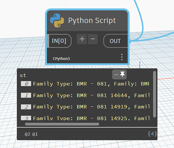

symbols = FilteredElementCollector(doc).OfCategory(BuiltInCategory.OST_StructuralFraming).WhereElementIsElementType().ToElements()
the nesting i assume u mean Family Name → Family Type.
