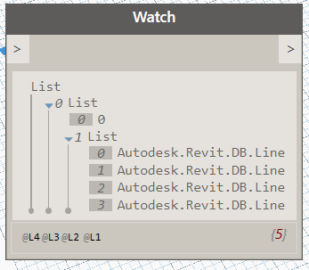

This gives the view boundary lines (in a list for some reason):
0 List
…0 List
…0 Autodesk.Revit.DB.Line
…1 Autodesk.Revit.DB.Line
…2 Autodesk.Revit.DB.Line
…3 Autodesk.Revit.DB.Line
The problem I have is that I now want to extract the start and endpoint of the lines, but when I try to take one of the lines from the list I get an indexing error:
File “”, line 40, in
TypeError: ‘CurveLoop’ object is unsubscriptable
Am I missing something? I think the problem is that the list is an Ilist, not a list, but I see no reason why I cannot extract items from it?
