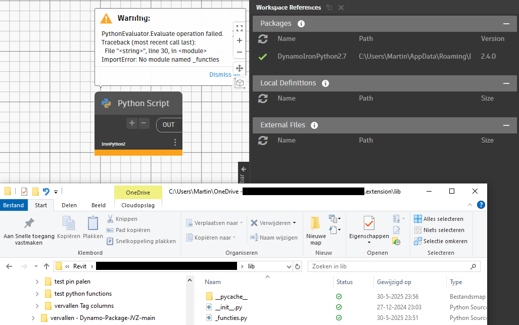

When I start my Dynamo-script in R25 it works 100%. (custom Python-functions are loaded/available)
When I start the same Dynamo-script in R24 it does not work. It gives: “importerror: no module named …”
So it can not find my custom Python-module and so it does not load my custom python functions.
In R25 I use the new Pythonnet3 package
In R24 I use IronPython 2.7 package
What can be the issue and whats is the solution?

Revit 2024 (and pyRevit installed): script with IronPython2.7-engine v2.4 gives an importerror.
Revit 2025 (and pyRevit installed): same script with PythonNet3-engine works.
Here is my code:
# -*- coding: utf-8 -*-
import sys
clr.AddReference('RevitAPI')
import RevitServices
# Importeer eigen python-functies.
import _functies as JVZ
# Verzamel alle palen (17 - Paalfunderingen) in document
palen = JVZ.CollectPalen(doc)
OUT = palen
I have pyRevit installed. “_functies.py” is in network folder ‘lib’. (see also The AI workspace that works for you. | Notion)
All files are inside network-folders. There are no local files in use. Only Revit is on my computer installed.
What I want is that it works in R24/25 but I don’t know why it’s not working in R24.
I only see that file “_functies.py” is not found with IronPython.
@c.poupin : Yes, my py module is a common library for several Dynamo scripts.
This is just a guess, but you are probably using the CPython engine on PyRevit, which is also based on PythonNet3, and the modules preloaded in PyRevit (possibly linked to the “site” mechanism) are found in the PythonNet3 scope of Dynamo.
As a result, it does not work with IronPython2, whose scope and operation are different in Dynamo.
Be careful with this technique, as it could cause conflicts between the two Python engines (PythonNet3).
It would be preferable to reference the Python modules in the DynamoPythonNet3 scope via
  • sys.path.append(path_py)
    or
  • sys.meta_path.append(finder)
    or
  • by placing your py file in the Lib directory used by Dynamo.
