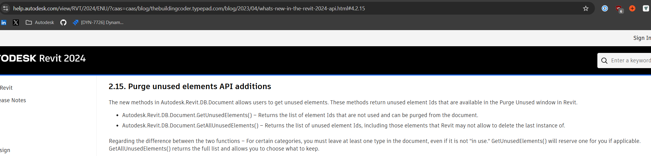

Hey,
Just to expand a little, ‘Purge Unused’ only got added to the Revit API in 2024… So all that stuff with ‘PerformanceAdviser.GetPerformanceAdviser().GetAllRuleIds()’ isn’t needed now (I don’t believe!)
Alban is doing extra stuff like removing Line patterns with IMPORT in them, I don’t think those patterns get removed by purging, so it is still interesting to read the code and see what is going on.
Hope that’s useful,
Mark

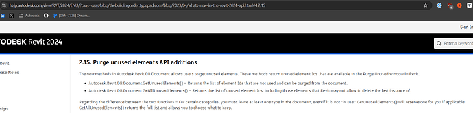

Hey,
Yeah you don’t want to use a postable, it’s very limited, basically it is a one time call to the API, you can’t then use the result to do anything more in the code.
To get the functionality of ‘Purge Unused’ without a postable, you can use ‘Get Unused Elements’ as of 2024.
Hope that helps,
Mark

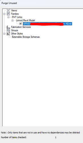

Nice!
It left in one purgeable item strangely
If you are going to remove all links from the project file you could just go over each of these categories and get all elements of that type, then just delete them.
