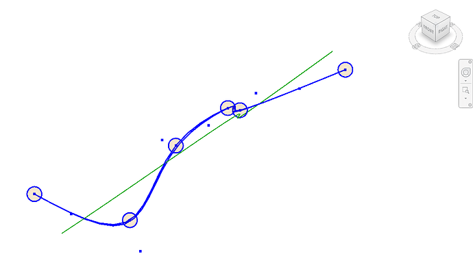

I need the Project model free form curve to exactly match the result of nurbscurve.bypointstangent.
modelcurve.bycurve using the result of nurbscurve.bypointstangent is not a match. Looks like it uses the dynamo curve points as control points.

this image … blue curve generated by nurbscurve.bypointstangent node … thin green is the curve created in the Project with the modelcurve.bycurve node … its not the same as the blue curve. we want the blue curve in the REVIT Project. Also … the blue spheres are the actual point XYZ positions provided (from EXCEL cells).
since posting this … I found a previous a very interesting blog post in a previous REVIT spline thread … https://parametricmonkey.com/2017/01/16/revit-splines/ … and … splitting the Dynamo nurb before connecting to modelcurve.bycurve almost works.
