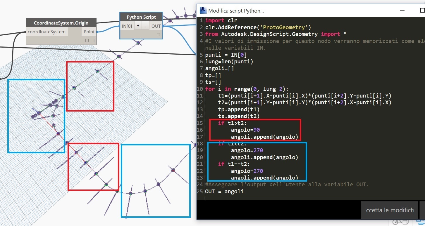

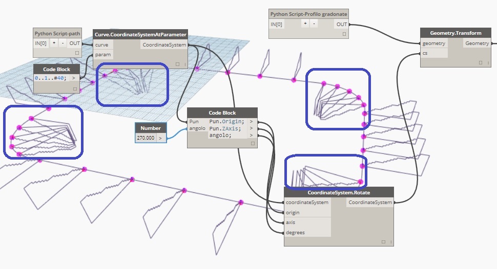

<br class=“Apple-interchange-newline” />Profile insert along a path <br style=“color: #222222 ;” />I created a path <br style=“color: #222222 ;” />I put the section <br style=“color: #222222 ;” />Cornering is not exact <br style=“color: #222222 ;” />any help ?? <br style=“color: #222222 ;” />Thanks for collaboration
<br style=“color: #222222 ;” /><br style=“color: #222222 ;” />
Sorry there is no demand :
I created a path
I put the section
any help ??

The method does not work with the formula <br style=“color: #222222 ;” />https://en.wikipedia.org/wiki/Graham_scan <br style=“color: #222222 ;” />There is another method ??
Hello Alex,
Why do you need to replicate the profile so many times along the path? I presume your end goal is to do a solid by sweep? If you, you only need a single profile:
You only need to do what you’re doing if your profiles are different in some way and you want to loft through them:
Thanks DIMITAR, VIKRAM
I wanted to have one section with the path
This works
Now I try with variable sections
