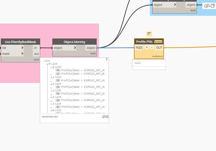

Can we do it for multiple profiles ?
PROFIL PVI EXPORT MULTIPLE-1.dyn (89.2 KB)
WA Aleykoum Salamun
TRY

Selamu Aleykoum @hosneyalaa
PVI_KIRMIZI_KOT_ALTIN_YOL_15-003.txt (2.6 KB)
PVI_KIRMIZI_KOT_ALTIN_YOL_15-002.txt (2.6 KB)
PVI_KIRMIZI_KOT_ALTIN_YOL_15-001.txt (2.6 KB)
TRY

Chokran akhi @hosneyalaa
Working…
Hi @abdullahcicek
to export multi .CSV as you have
Hi @hosneyalaa
I set it exactly how I want it and it works fine.
Thank you brother for your contribution.
