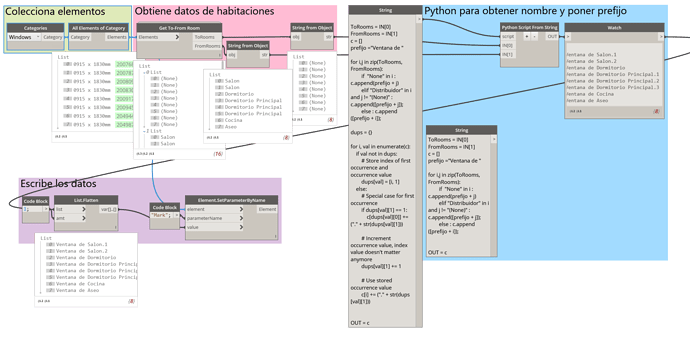

I’ve created a script to automatically set the Doors / Windows mark based on the ToRoom FromRoom information.
It collects the Doors / Windows and the ToRoom /FromRoom information and with a simple python script using IF / ELSE statements assign a prefix and a name to each mark, then sets the parameter.
I added a bit more code to the python script to add “.1”, “.2” etc in case the Marks are duplicated.

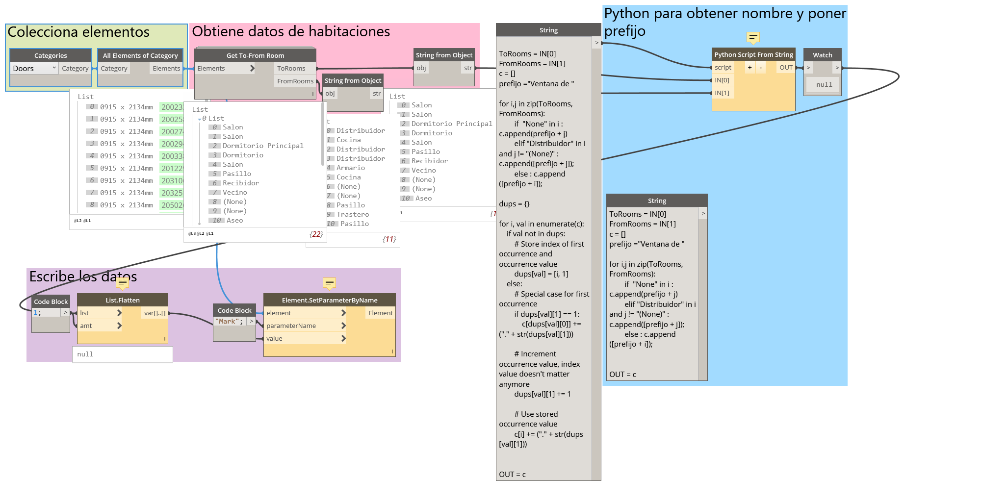

It works fine with windows but the python script gives an error if I change the category to Doors (however it works with Doors if I remove the code that adds the suffix).

I’m using Dynamo 1.3.1.1736 and Revit 2017 x64 1 build 7.0.416.0
Same, with Doors:
Doors, but removing problematic code from Python:

Much of your screenshot is illegible - can you do another export?
Edited: changed the pics. The .dyn is there as well.
The error is list objects are unhashable, even they are converted to string and are the same as the windows script
Sounds like you need to incorporate a means of dealing with the list. Post the Python script with the preformatted function and hopefully someone more Python savvy can weigh in.
Sorry for the delay, this is the code (IN[]0 and IN[1] are converted to strings before entering the Python script. Maybe the problem resides in the NULL elements):
