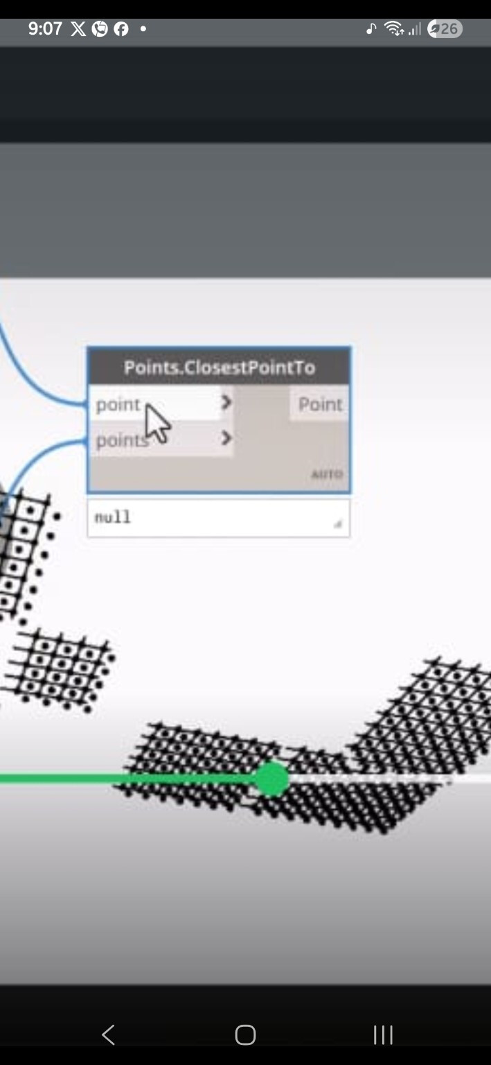

Points.ClosestPointTo cant find this node
i have 2 lists of points and i want to get the closest point from list #2 to list #1

i thought the same but i cant fine it

geometry closest point to gives the same 3 points from list 1
Can it be that the list you feed into other has the same Elements as the list you feed into geometry and thus the same location?
List.MinimumItemByKey, where the key is the Geometry.DistanceTo node with only the sample point in it, and the list is the flat list of all other points.
