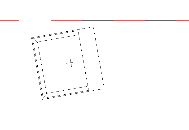

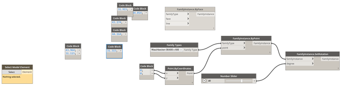

i placed familyinstance of sanitary by point in dynamo . Now as i placed the sink but while rotating u cant guess its rotation point as its changes , i want its rotation point as im placing sanitary things in my model by point and needs rotation on some points

i tried rotation but other things like toilet etc , they have clear center point and degrees are working but in this sink center point is not clear

anyway i think your problem will be solved by editing the sanitary family and specified a proper center point to use it perfectly
im using pre defined families in revit to place it … toilet , shower area are fine but sink rotation created problem
Please upload a sample Revit model and Dynamo graph showing how you are rotating the elements so we can help you. There is too much of a guessing game to find the issue without that common base data.
