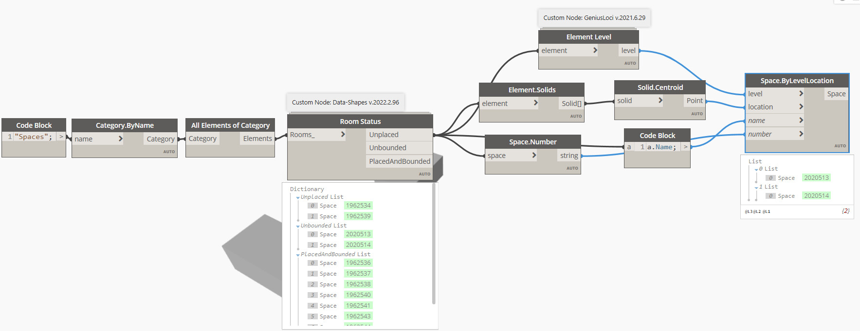

Hello @bwilkeA77N6 …Dont know there should be a better
way, but you can try this here…
Thanks for your suggestion. I will give it a try and let you know how i went. :slight_smile:
Element.SetLocation might help too.
Yes Jacob, great idea, but have tried it doesnt work for me
Yeah seeing the same thing…
Apparently the method to place an unplaced room is to use a UV value and the plan topology which is not an easy task. Likely easier to make new rooms and copy over parameter values as noted above.
