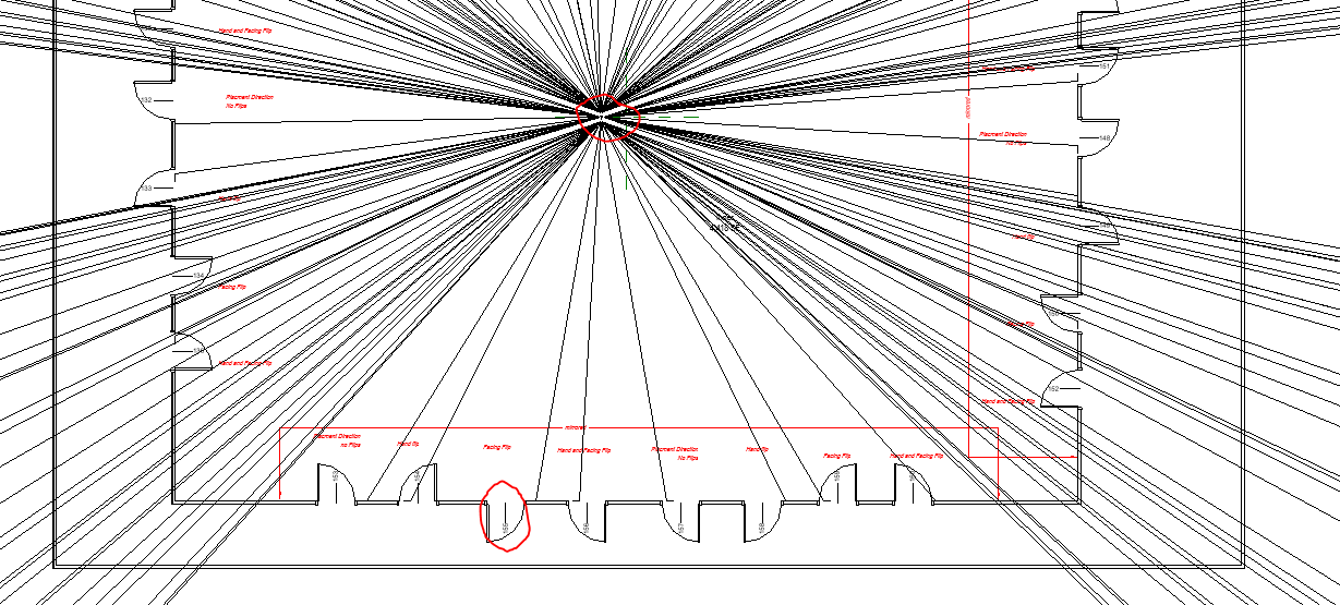

I am trying to tag specialty equipment in a particular view after placing it. I have tried almost all of the tag nodes (all otb and 2-3 from various packages). Each of the nodes place tags at the origin of the project.
I found a bunch of working examples for other categories so I tagged all of the doors in the view and they are working fine. In the first image below you can see a bunch of leader lines running from the center. If you look at the doors though you will see they are tagged appropriately.

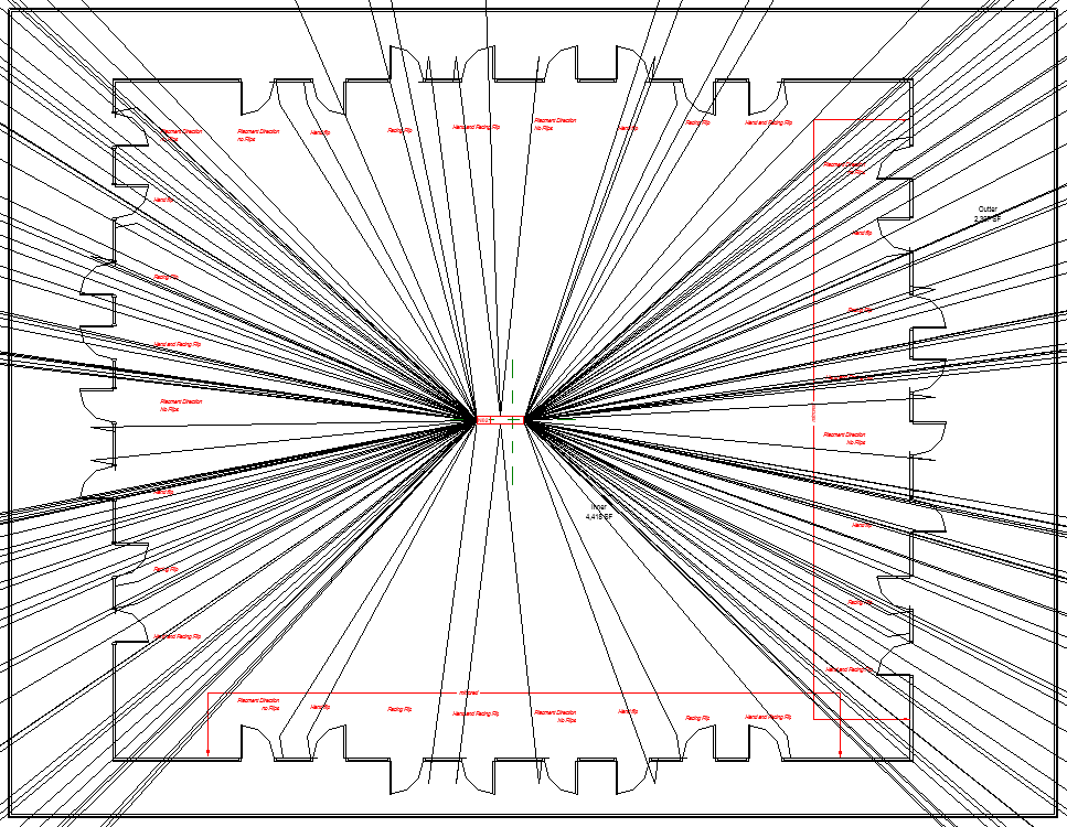

I found Creat Independent Tag from GeniusLoci’s package (its an updated version of archilab’s Creat Annotation Tag). As you can see in the image below I was able to get the tags to place in the correct location however, they do not have leaders. I edited the code to turn on leaders and all of the tags are again placed at the origin (see image 2).

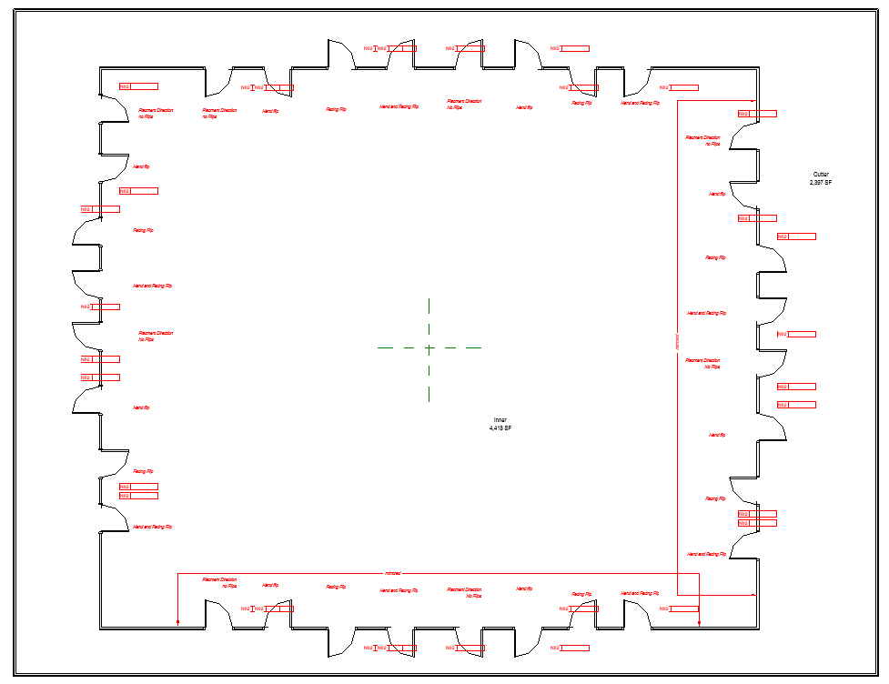

After sleeping on it and beating my head agaienst a wall I added a Transaction.End after the elements are created (Springs.HostedInstance.ByPoints) and it is now working. I guess there was just a hang up in the transactions.

I did not change any of the code. After I placed/created the new elements I added a Noded called Transaction.End. This node will stop all Revit Transactions before starting the next portion of the script. Sometimes Revit just moves too fast for its own good.
