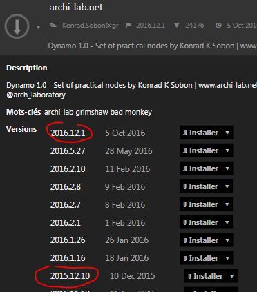

I Dynamo 1.2.0 and REVIT 2015
I installed the latest version of Archi-lab.net 2016.12.1
But I still have the same problem with FamilyInstance.ByFace
For the node Get Linked RVT Document Error: the custom node definition is not charged
Tuning
With REVIT 2016 it’s ok to FamilyInstance.Face
Must install the module 2015.12.10 REVIT 2015?
How the Get Linked Document node?
