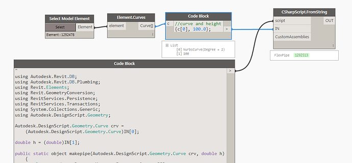

Hi , I have a doubt when using Revit API and zero touzh
I have the following code to create for example a flexpipe in one of my custom libraries.

My problem is that every time I run the node, the pipes and change for example the lenght of the pipes, it doesnt modify them but creates new instances. I just want to modify the instances created.
The other problem is that it creates everything in what i guess is imperial system. (I work with meters but if i change to feet, it goes ok, how can i change this.
You’ll need to return the pipe element to Dynamo and ideally wrap it so that the node can track it and not duplicate it. To do that, you’ll need to change your code a bit and use the “ToDSType” method on the flexpipe element.
If your code will run from Dynamo, It’s strongly recommended to use Dynamo’s built in transaction manager.
I was a little confused about using dynamo´s built in trasaction since in the wiki about zerotouch they don´t mention it and it says people should use using or dispose.
