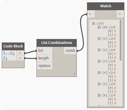

  2. You could try Dynamo’s built-in “Combinations” node as an alternative:
ok.
I did try the List.Combinations node but I did not get what I needed.
