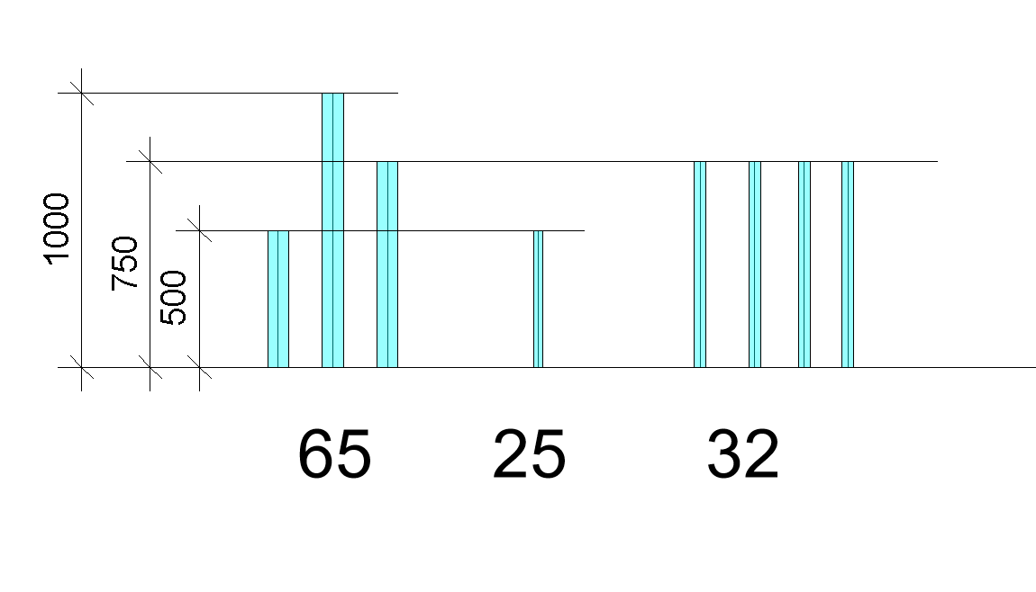

Hi all,
I want to order my some pipes by size and length, to number them for prefabrication.
blue 1: this is my list with pipes
blue 2 and 3: this are the lists with the size and length.
blue 4: this is the list I need.
I need them to be sorted by size and then the sublists of each size needs to be ordered by length.
If you look at blue 4: the green *1 all are same lenth, so order may be anything. The green *2 are different length, so order needs to be in order.
Hope I make myself clear.
I tried a lot already (SortByFunction / SortByKey / … / …)
But can’t get it accomplished… the sort functions still give me a lot of headache lol…
this are the pipes for explanation
Sort by length first, then sort by size. This will return a flat list from the shortest of the smallest size pipe to the longest of the largest size pipe. This is done with a pair of List.SortByKey nodes.
If you want to have them grouped by size, swap the last of the List.SortByKey nodes with a List.GroupByKey node.
