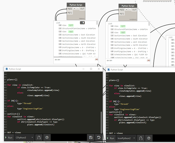

Just wanted to add a note here: Due to how they are designed (Out of our hands), there won’t ever be full parity between IronPython2 and CPython3 unfortunately. We have reached a large degree of parity, but to cover other bases we also now ship IronPython2 on the Package Manager to enable you to keep your original content and workflows
Any ideas on how to resolve this difference? I want to return the actual type, not the value number.

CPython returning different results than IronPython
below is the result in both versions of the list named “views”
and now the result of view.ViewType
any ideas?
clr.AddReference('RevitAPI')
import Autodesk
import Revit
import RevitServices
import Revit
dataEnteringNode = IN
reset = IN[0]
if reset > -2:
collector = FilteredElementCollector(doc)
viewz = collector.OfClass(View).ToElements()
viewlist = list()
for view in viewz:
if view.ViewType == ViewType.ThreeD:
if not(view.IsTemplate):
viewlist.append(view)
else:
viewtemplates = []
views = []
plans=[]
for view in viewlist:
if view.IsTemplate == True:
viewtemplates.append(view)
else:
views.append(view)
if IN[1]:
typ='ThreeD'
else:
typ='EngineeringPlan'
outlist=[]
for viewinst in views:
outlist.append(viewinst.ViewType)
if str(viewinst.ViewType) == typ:
plans.append(viewinst)
#OUT=views
OUT = outlist
