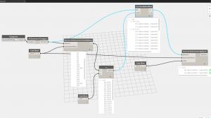

Hello Tran,
This will get you started. It doesn’t yet contain the filtering, but start playing with ‘Filter.ByBooleanMask’ and do a bit of a search on the forums for examples.
See attached Image

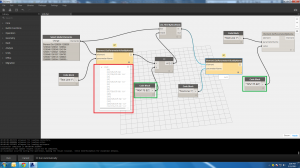

Tks all. I have a problem with my dynamo node.
I don’t know how to sort&list for red box on image i attached.
Can it make two list for parameter “Text Line 1” ? I want to set parameter for “Text Line 1” by replace list 1 from list 2.
Try using a formula node instead of ==. I’ve not had much success with that
Formula: a==b
May i can make a list for red box on image which i attached ?? There are so many elements with the same contain. I want to sort them with the unique items.
