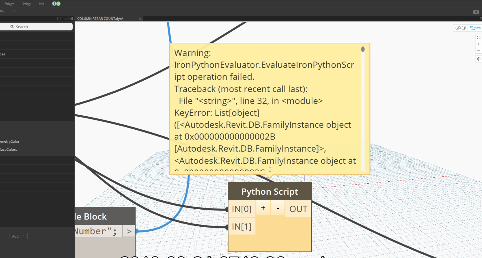

What are you trying to obtain? the total number of rebars? When I try to copy your code I get many errors.
Is there a reason why you want to use dictionaries?
PS.could you also post a picture of the error you are getting please?

Please excuse me but I still do not understand why you are using dictionaries, python and what your final goal is.
Do you want to count the total number of rebars in each column? Or for the whole project? Or the diffferent types of rebars? I think that the REBAR_NUMBER does not tell you how many rebars there are but simply the different types in a partition
can you please also paste the code as preformatted text… This makes it possible for people to actually copy/paste it and help you discover errors… This can be done using this icon:
In that case there is definitely some issues with missing indentations in loops etc…
This would be preformatted:

Assuming I have not missed any indentations (as they had to be added manually…)
for each column I want to count the total number of rebar of the same rebar_number. this is essentially what I want to do. There should some code to check the equality of the rebar numbers but that I will look later but want solution to the current issue

Exactly as you have displayed in the image. to make it clearer I have attached an image of my dynamo graph and how I wanted it to relate to the python script
I’m not good with dictionaries in python but I think you aren’t really creating a correct dictionary,then I do not think you are actually reading the rebar number parameter, nor should the .Count() method work…
Anyways I cleaned up a little bit your script (you were grouping and then selecting the last list instead of filtering directly the rebars hosted on the columns with the List.FilterByBoolMask) and I also added both my old version plus a new (ugly) one in python: rebar2.dyn (43.7 KB)
This is the python code of the “short” node. I used long variable names to explain better what I’m doing. I’m sure there is a better way to do this, but for better troubleshooting you could just use the dynamo nodes I showed in my previous post.
