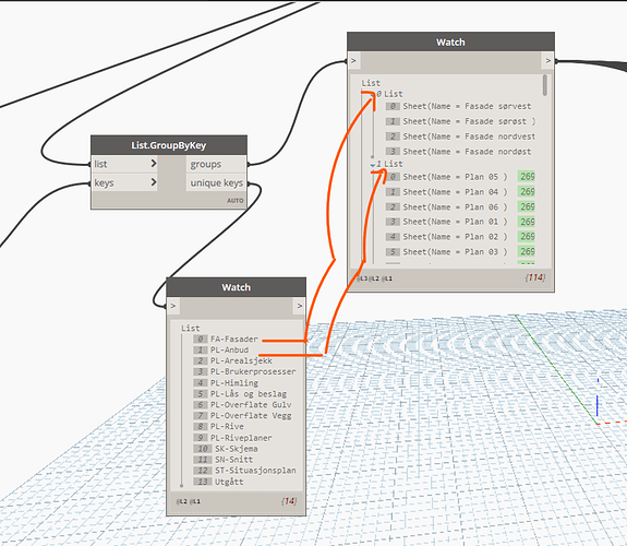

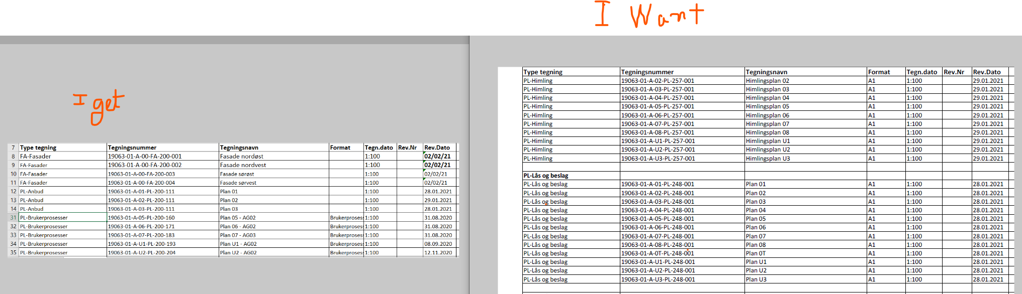

But my goal is to get first the unique key then the list at excel

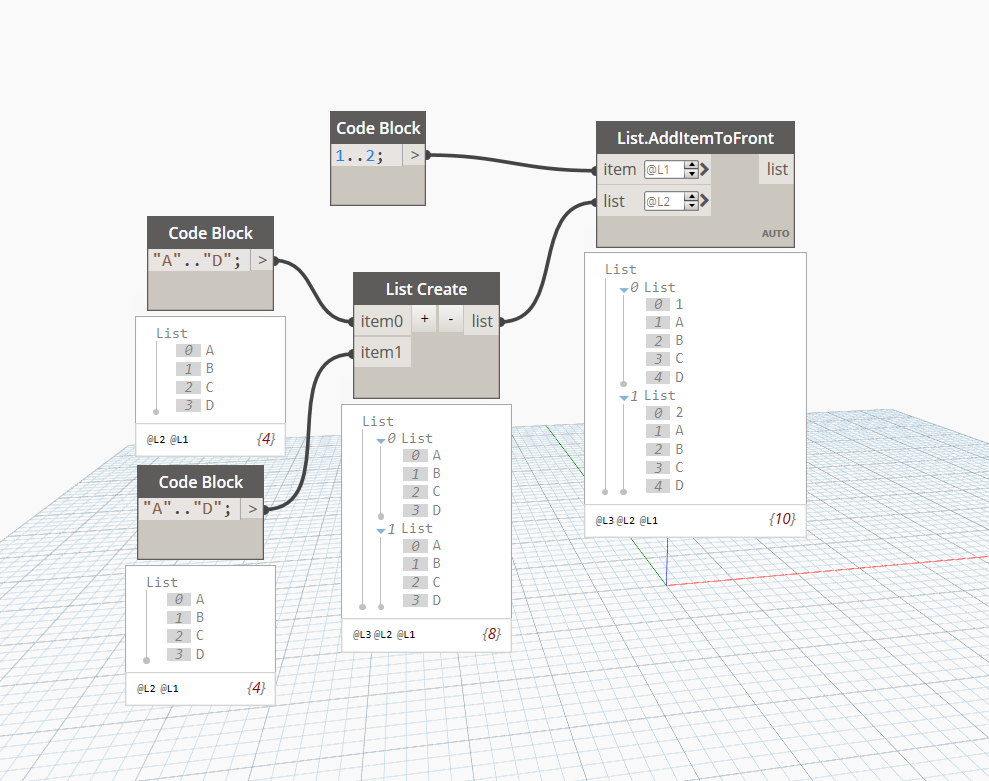

you can try with
List.AddItemToFront
note for this task.
