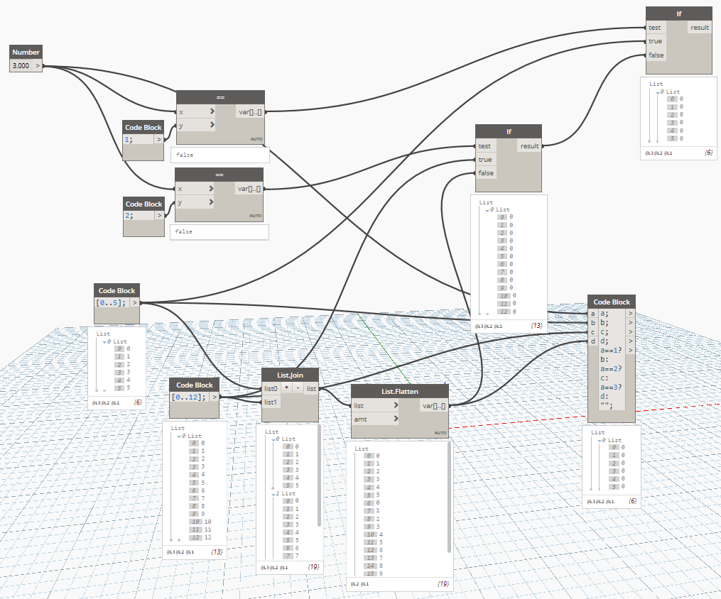

I am creating a graph that has two lists. Depending on the users input (in this case 1, 2, or 3) I want to either send through the data from list 1, list 2, or a combination of the two. In the example below, I am using the Number on the top left to represent the users input. There are two lists, one with 6 items and one with 13. Based on my “logic” I expect the following results: user enters 1 and gets list 1 with 6 items or user enters 2 and gets list 2 with 13 items or user enters 3 and gets a combination with 19 items.
The problem is that whatever number the user enters, I keep getting list 1 regardless. The first if statement is updating properly but the second if statement seems to not care.
Thoughts? Did I miss something stupid? :slight_smile:

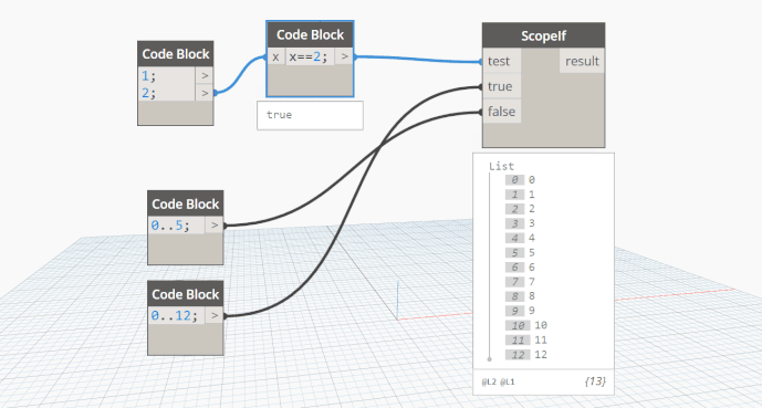

Use ScopeIF node instead:
Keep in mind ScopeIf only works if the inputs are self contained as it only runs one input at a time. For this reason it’s good to get familiar with the index method that @Kulkul showed.

You are inputting a value into an IF node, this if node only works with a boolean value, so you should place and == node / “x==1” node in between.

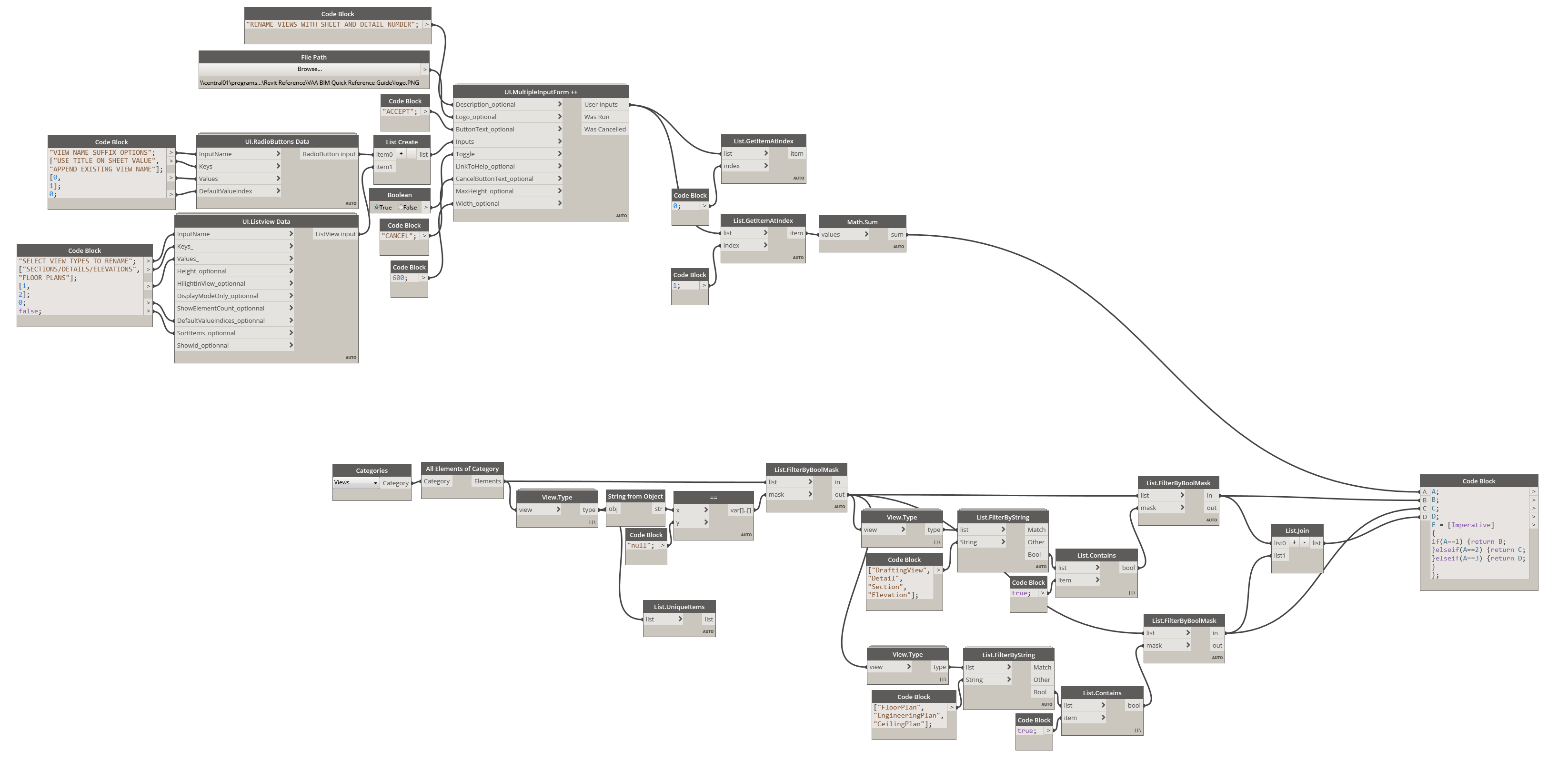

@Daan @jacob.small I simplified the graph to illustrate the problem I am having with a bigger graph. In the actual graph, users are picking an option in a Data Shapes UI window. The results are either 1, 2, or 3 which are then fed into the logic statement that I posted here.
@Daan I do not understand what you mean by this. Both of my IF statements are currently fed with booleans into the test input.

@Daan That did work. Here is that method worked into a larger portion (still somewhat simplified) of my graph. I forgot to mention that the two inputs the user gets produce a 1 and a 2 and if they select both the Math.Sum node produces a 3.
