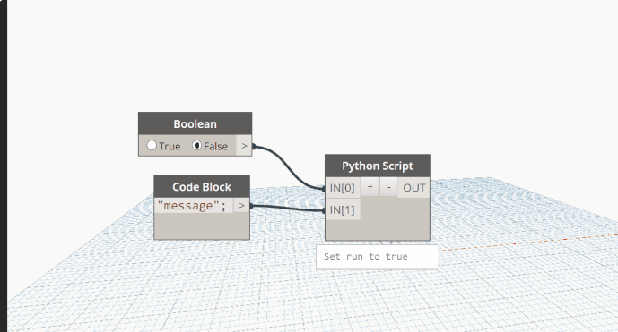

Here is an all python way with a true/false toggle as well.
import msvcrt
clr.AddReference("RevitAPIUI")
from  Autodesk.Revit.UI import *
button = TaskDialogCommonButtons.None
result = TaskDialogResult.Ok
if IN[0] == True:
	TaskDialog.Show('User Text',IN[1],button)
	result = IN[1]
else:
	result = "Set run to true"
OUT = result
and in action
