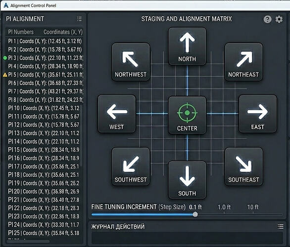

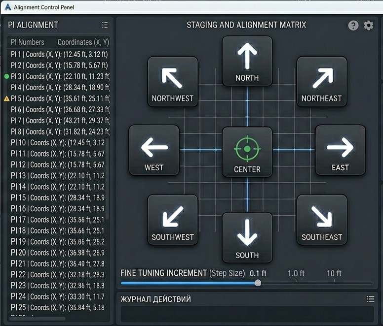

Good day!
Is it possible to move the alignment intersection points via Dynamo or C# .NET?
How can this be done?
Thanks, expert with forum Autodesk Community
