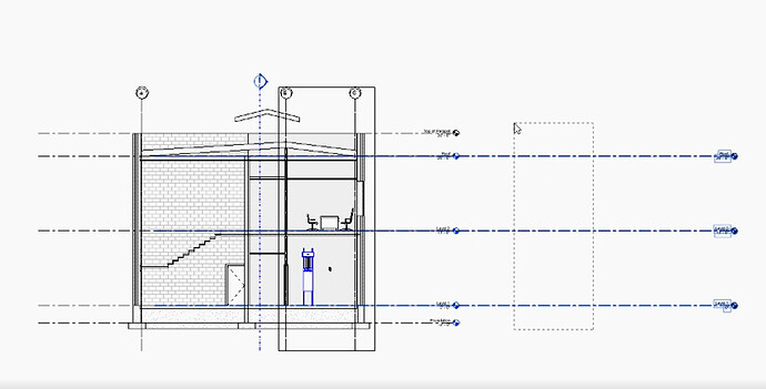

The problem I am running into now is the extents are different from the old ones.
As you can see in the image my newly created Levels do not line up with the levels I copied over. Anyone know how I can harvest the extent locations of the old levels and make my new levels hold those values? Preferably would like to do this through Python Nodes and the API, Thanks!
