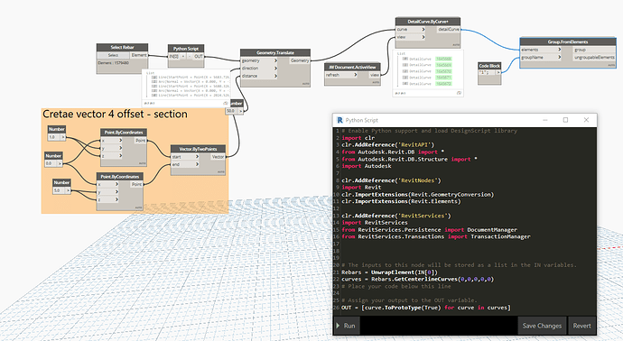

I’m creating a detail lines from Rebar element in section view and i want to move them to plan view ,
is there a way to do that?
the result i expect to create 2D lines from Beams rebar in plan.
can you please post the DYN and the Python code here on the forum? It will be easier to read and to help you. Thanks.
2DBeamRebarInPlan.dyn (40.6 KB)

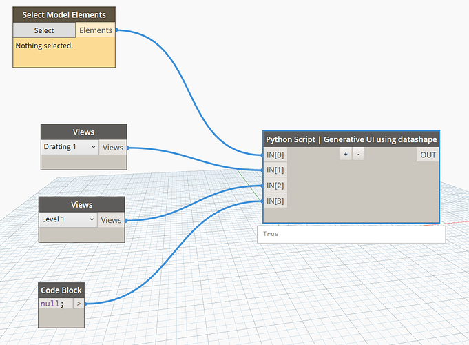

what this code supposed to do?
copy from drafting view to floorplan? thats what you need right?
right to structural plan,
it doesnt work for me ,
could u please show me how it works for you ?
erm, so basically IN[0] is your detailed lines, IN[1] is the view where your detailed lines reside, IN[2] is the view that you want your detailed line to be copied to, and IN[3] is the transformation (basically the coordinates to shift it up down left right)
