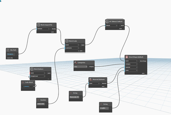

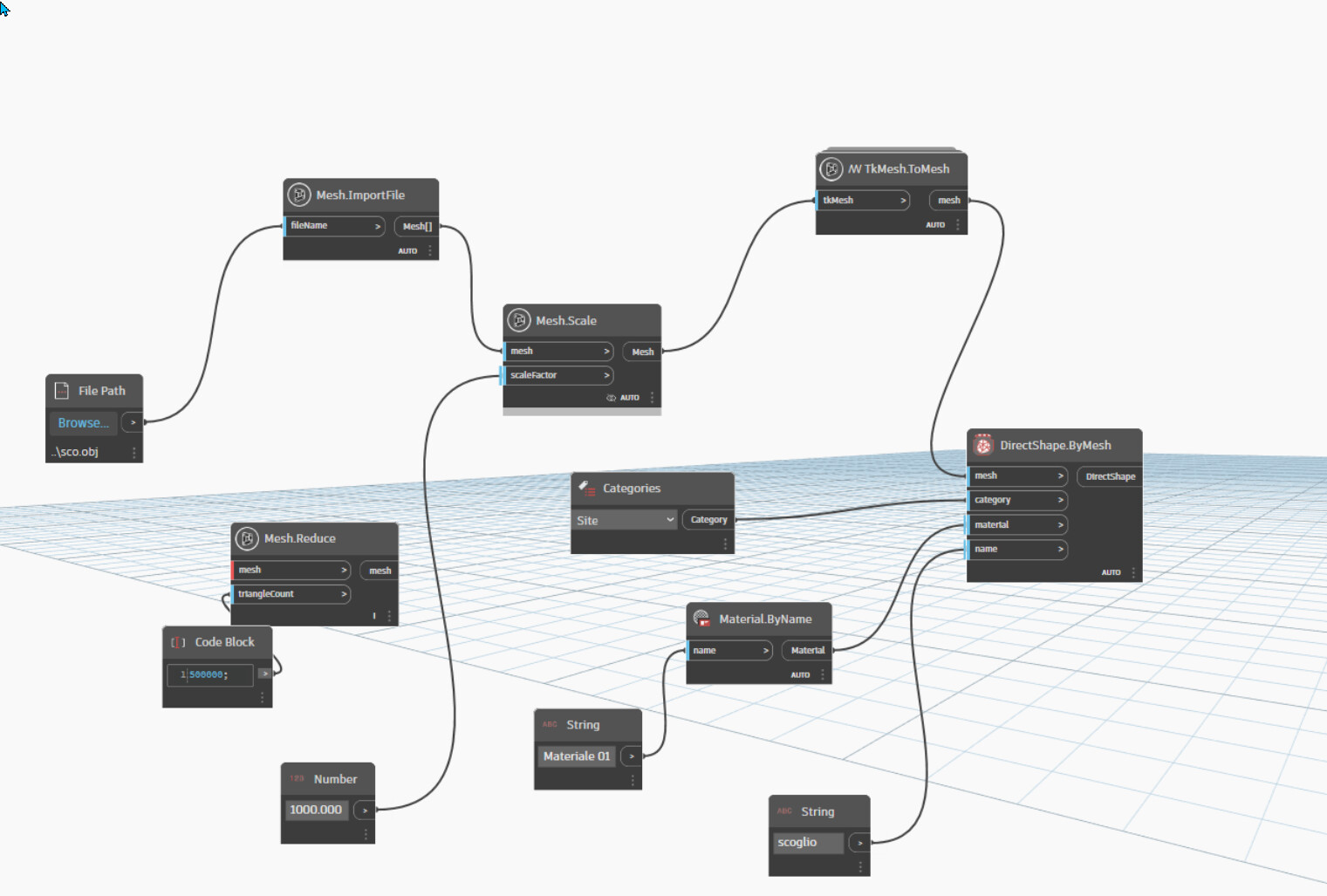

we can use mesh in revit mesh using script like (attached), it works good from me, i need to understand if it’s possible to define by similar process mesh in revit with right texture defined from an example a photogrammetry process.
If you want proper UVW mapping, I think the answer is no, for materials you can just use box projection.
But if you want to display point clouds with RGB textures in Revit you have to use Recap for that. Recap can read a lot of pointcloud formats, and you can display everything in Revit as it looks like in Recap:
https://help.autodesk.com/view/RVT/2023/ENU/?guid=GUID-D179BB6C-5528-498F-9413-00237092C2FA
Thanks Infeeee…, I don’t have problem with point clouds I trying to find some workaround to properly set material and relative texture in revit when I need to use mesh.
Thanks again
