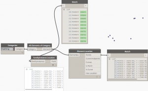

I am trying to get the origin locations of the connectors on a fitting.
?? is it possible

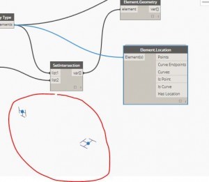

Absolutely, Timothy.
You can either use the built-in “FamilyInstance.Location” node or if a certain fitting is being problematic, try the “Element.Location” node from the clockwork package.
I am afraid it gives you only the location/insertion point of the geometry, not the connectors…Help?
