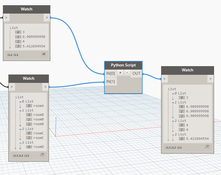

Hi Ahmad_Saad,
I think i understand your question, it can be fixed with a simple python script that reads the data form the math.sum list and put this in a structure similar to the roomlist, see the image.
below the Python script i made with some comments:
#The inputs to this node will be stored as a list in the IN variables.
dataEnteringNode = IN
sumlist = IN[0]
roomlist = IN[1]
#make an ouput list
output = []
#for each element in sumlist
for idx, i in enumerate(sumlist):
	#get the matching roomlist item
	rooms = roomlist[idx]
	#get amount of rooms in the room item
	numberOfRooms = len(rooms)
	#create a new list
	newlist=[]
	#fill the list with the i form the sumlist as many times as there are rooms in the rooms item
	x=0 #make a counter
	while x < numberOfRooms:
		newlist.append(i)
		x=x+1#add 1 to the counter
	#append newlist to output
	output.append(newlist[:])
	#delete newlist
	del newlist[:]
#Assign your output to the OUT variable.
OUT = output
I hope this works for you.

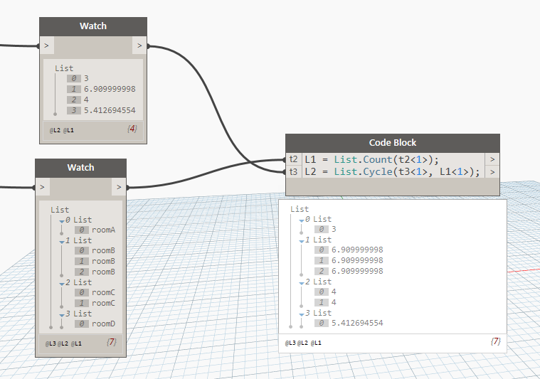

@Ahmad_Saad Here is another possible way:

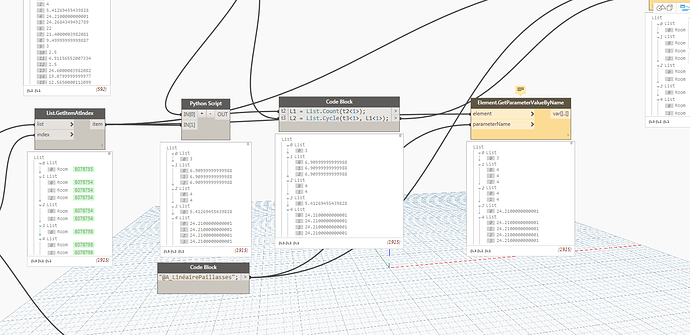

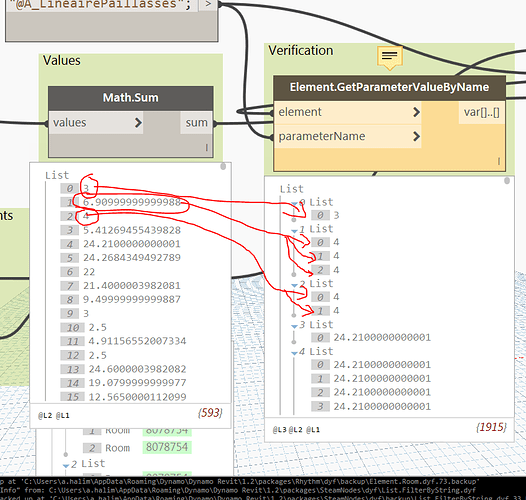

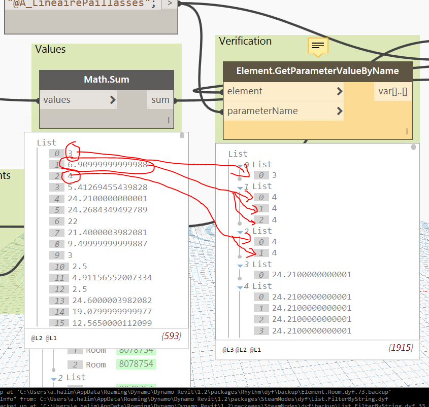

But the last step; which is actually my main purpose is pushing these data (the SUM values) to the rooms, by using the node “set parameter by name”. This step unfortuantly, didn’t work.
I am sure I am missing something or doing something wrong.
Please find attached:
The problem is that it doesn’t feed the correct values. You can see that in the “Element.GetParameterValueByName”
Regards
Please notice that the error message is saying: Warning: Internal error, please report: Dereferencing a non-pointer
