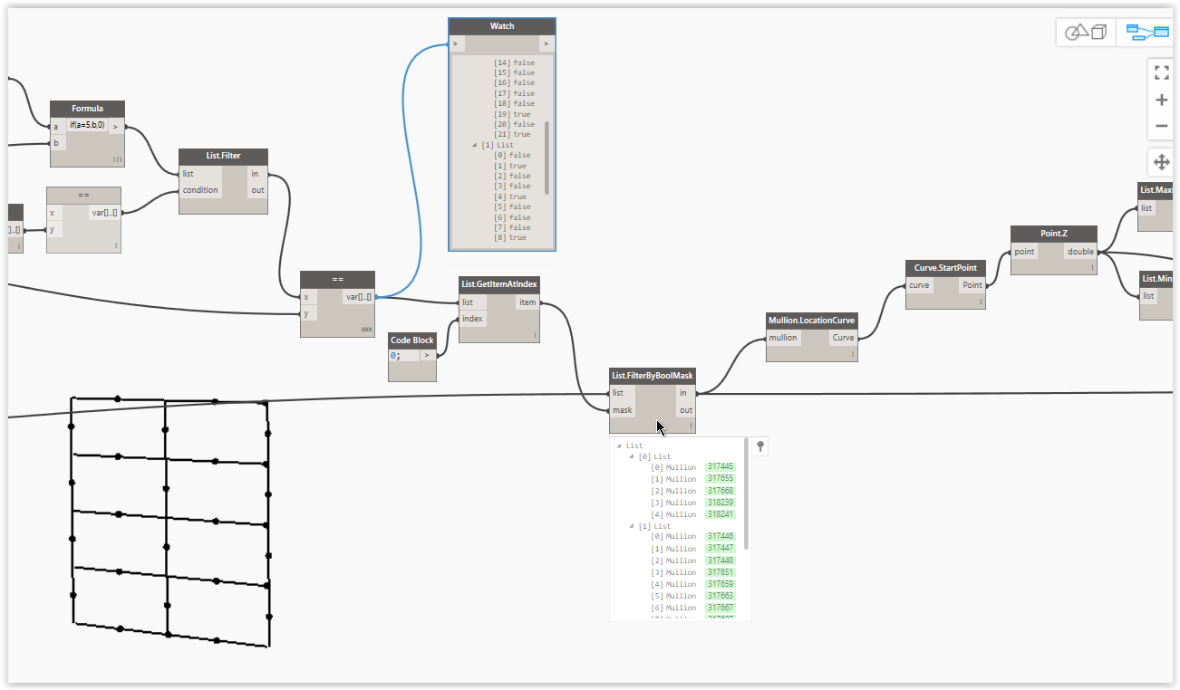

I’am trying to make a list with 2 lists. The 2 listis will contains all horizontal mullions. See pictures.
Later on I will delete all mullions except 1 random mullion.
It works for now, But I must use “getitembyindex” for each listi.
Hope you understand my quesetion

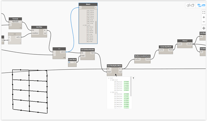

But in the picture you can see the problem.
I can’t put to sublists in to the list.filterbyboolmask.
But if I put getitembyindex it works.

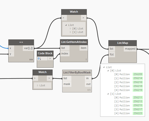

You will need to use List.Map as you are applying two different filter masks to a single list
Thank you very much Virkam, that solves this problem.

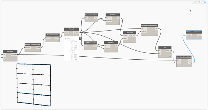

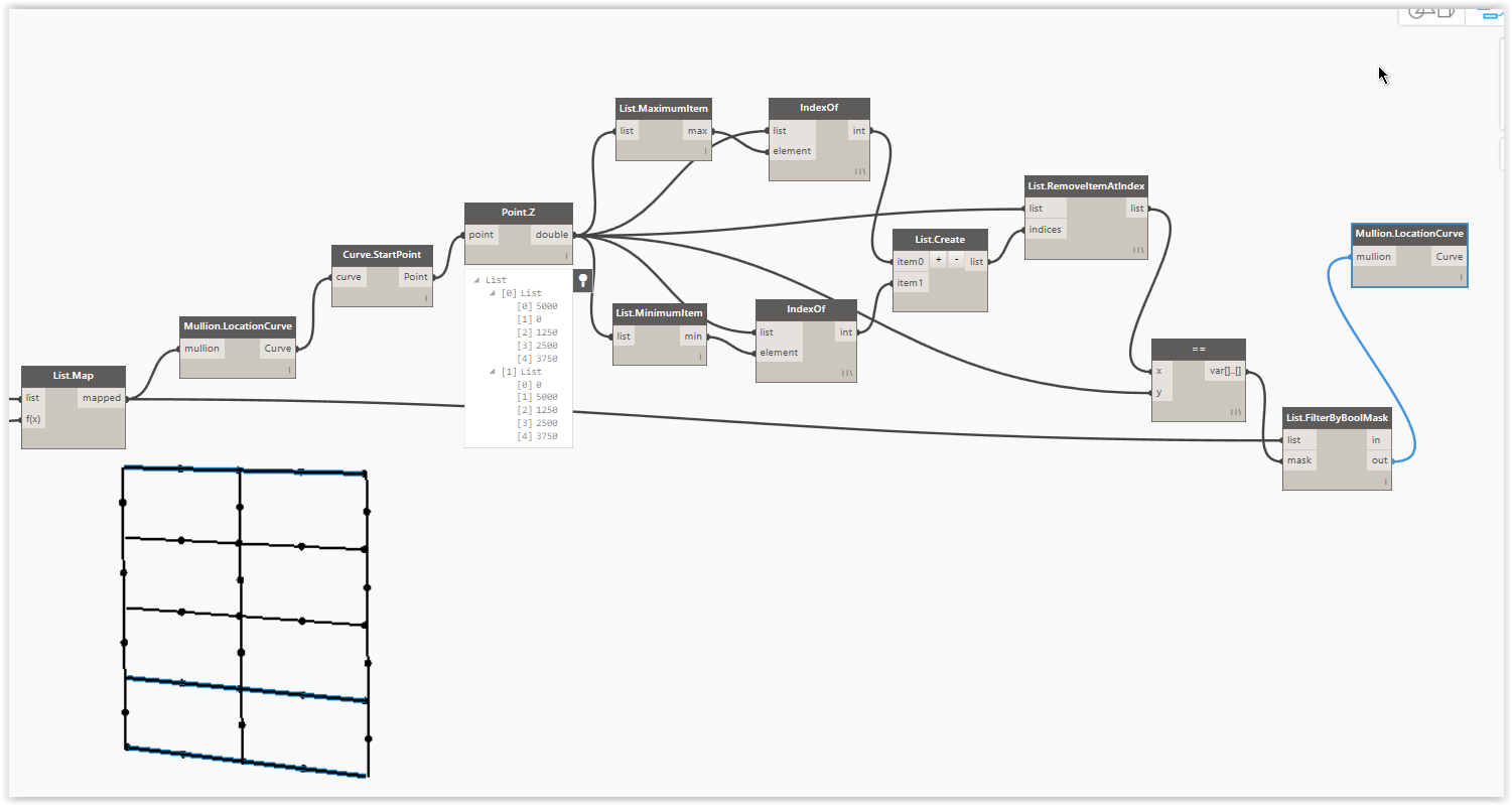

I wan’t to remove the higest and lowest mullion in the list…
It seems to work, but it don’t
do you see the problem?
The problem is that you are trying to remove items at two indices at once.
Do it in sequence - First remove the min item, from the resulting list remove the max item
That was it.
