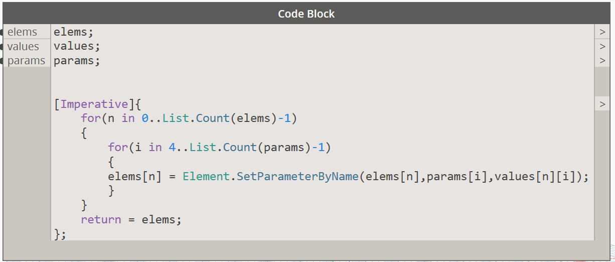

what for multiple elements, how do you another level of loop for elements???
Hi.
Short and lazy way : create a custom node and feed it a list of elements as one of its inputs.
However, I would recommend re-writing the code from scratch to adapt it to your needs.
I am just a bit confused about the return of for loop, I don’t know any python or javascript.
Anyway, I did a 2 dimension loop, The logic seems ok. And it’s somehow fonctionnal, even though very very very long.
ForLoop
I agree that it is a bit confusing at first, but that’s how DesignScript works. It allows you to store values computed in the imperative block outside of said block.
It is indeed long because that is in no way an optimised way of achieving this specific goal, rather an “ad hoc” solution… There must be a better thing to do, maybe through Python, using a custom node, using specific lacing, etc.

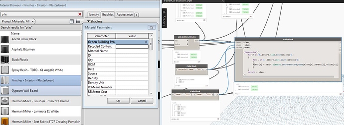

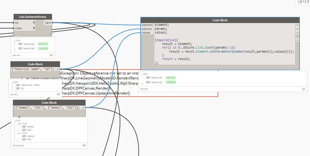

Can you please help me to get it work with multiple elements?
Hi, doesn’t this post help you figuring it out ? It seems correct to me.
I tried this also. But didnt work
Could you show your attempt and explain why you think it is not working ? I have answered this post nearly a year back now
Thanks, it worked.
Though it gives me no warning or error. But the value doesn’t seem to set in the Revit as you can see in the attached picture.
Can you please help me out?
