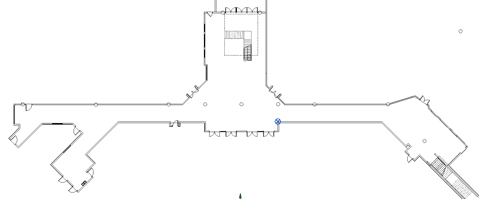

Very cool. To give a bit more of an idea of my situation, see the attached image. I’m creating a new ceiling in an existing space with a weird shape.
This baffle wave ceiling is the driver. This should be spanning north-south in the long, east-west corridor. But where the big central space happens, that baffle sine wave should peter out into the big central ceiling. Hence the dampened effect. So I’m figuring 2 -3 peaks in the corridor width, spaced evenly apart. So maybe every 5 feet or so. With an amplitude of about 1 foot. And dampening at the central space in 2 or 3 additional waves. So my final result is not a square, or any sort of regular shape. It will be a Boolean cutout of the waves to fit this bizarre hallway.
