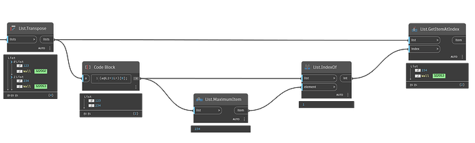

I am trying to retrieve the maximum wall width along with the ID of the corresponding wall.
It may seem like grouping related values/objects into sublists is the best way to maintain a relationship, but it actually makes list manipulation very difficult. Maintaining relationships through indexes of separate lists actually makes things a lot easier. Using something like List.GroupByKey or List.SortByKey allows you to manage two lists independently while maintaining the proper indexing relationship.
Another way is to use List.IndexOf and List.GetItemAtIndex nodes.
Nick’s solution is good though
