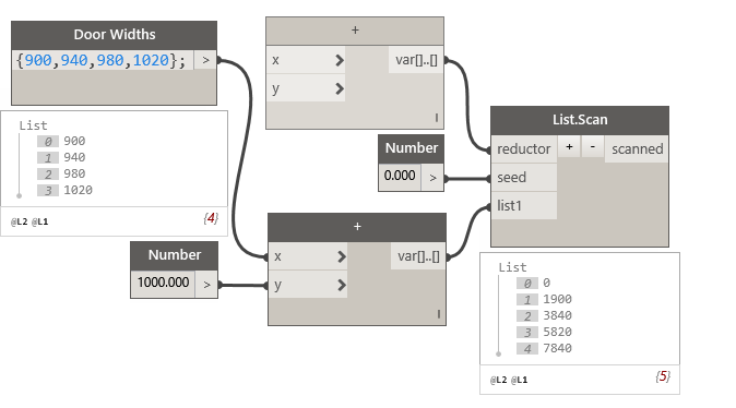

what I am trying to do;
  • Extract all the doors in a project (complete)
  • get the door widths (complete)
  • Insert them in a wall (complete)
  • The doors to be spaced 1000mm from opening to opening. (this is difficult)

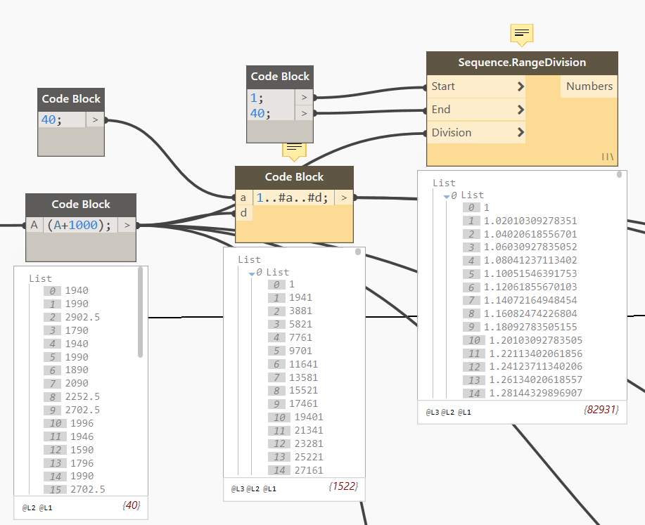

I cant seem to find a way to space the door 1000mm apart?
I have tried using the Sequence.RangeDivison node with not luck. it does divide them but it break each space into another index.
I have also tried a code block as well and i get a similar result… does anyone have some ideas?
see math i am trying to do in dynamo (you can do this easily in excel but i want to do it in dynamo)
Door900+Spacing1000= 1900
1900+Door940+Spacing1000= 3840
3840+Door980+Spacing1000= 5820
5820+Door1020+Spacing1000= 7840
sweet thanks Vikram
