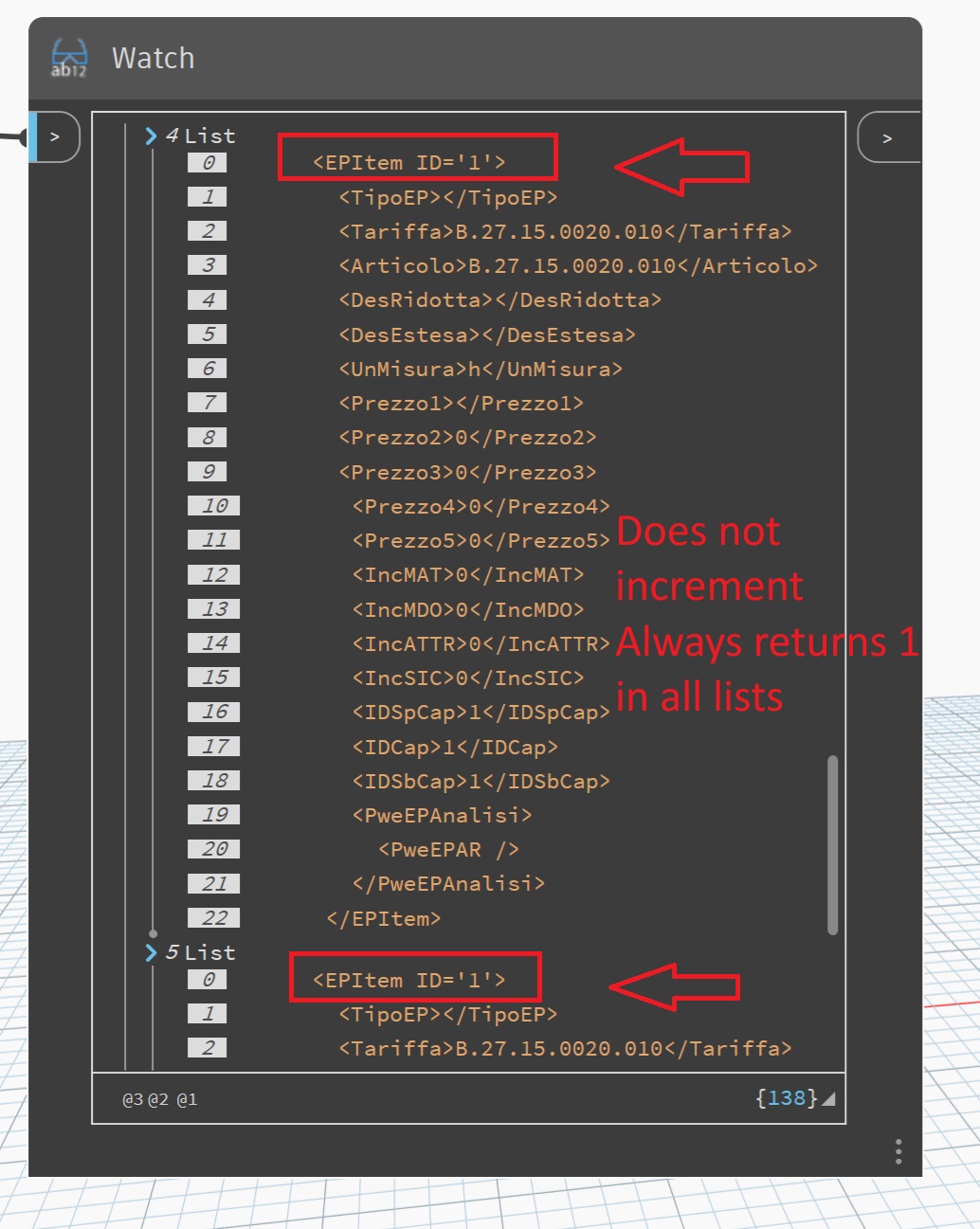

List sublist
I create the list LISTSOM
made up of 5 identical sublists
With for loops I search
where each sublist contains:
<EPItem ID="">
must transform them into
<EPItem ID="1">
<EPItem ID="2">
<EPItem ID="3">
<EPItem ID="4">
<EPItem ID="5">
It only takes
<EPItem ID="1">
for all sublists
It doesn't increment
num=num+1
I don't understand... it only takes 1
See attached images
Help?

Thanks for the reply.
Maybe I'm wrong, but I can't find
I entered
str1="      <EPItem ID=\"\">"
str2="      <EPItem ID=\"\">"
In the list, I should find:
         <EPItem ID="1">
	     <EPItem ID="2">
Instead, I find
         <EPItem ID="1">
	     <EPItem ID="">
or I find
         <EPItem ID="1">
	     <EPItem ID="1">
Another way
to use increment
H=H+1
always results in
<EBItemp ID="1">
<EPItem ID="">
In practice, it does not increment H

Thanks for the reply,
but it doesn't work.
It always returns:
<EPItem ID="6">
in all sublists.
It doesn't increment.
The list has only one index, so it doesn't work (image 1).
It works with two indexes (image 2).

Good morning
An oddity
If I separate the Python into two parts, I get the expected results (image 1).
If I don't separate, I get errors.
(image 2).
