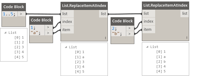

For example, If you want to replace items at indices 1 and 2 you will need to do something like this

I’ve just tried to explain the limitation. (You won’t be able to replace multiple indices in a list simultaneously)
You’ll have to come up with a definition that uses List.ReplaceItemAtIndex sequentially, such that it replaces one index of list, then another index of the resulting list and so on (any number of times)
