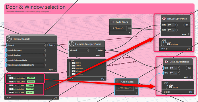

I’m facing an issue while trying to filter doors and windows separately. Please advise
Got it…
I think you might get better results with the list levels set to @L2 in both cases.
After filtering, I need the previous list with the respective option.
Instead of filtering via set difference, use a List.FilterByBoolMask where the list is the list of elements and the mask is Element.CategoryName into an == node with the "Doors" or "Windows" string as the second input.
Getting only one door instead of two.

Perhaps this helps…

Thanks…got it.
