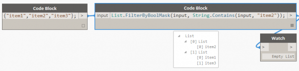

I’m going over some scripts of mine trying to compact them down and while doing so I stumbled upon a strange thing in the code block node. I’m trying to use the function List.FilterByBoolMask in a CBN, but it’s acting strange. The output of the square box doesn’t match the output of the “>” as you can see in the image below. The Watch node says it’s an empty list.

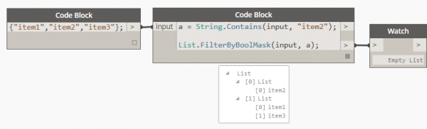

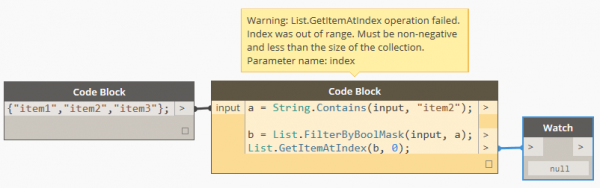

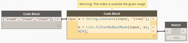

So I started fiddling around with the List.FilterByBoolMask and none of these ‘workarounds’ are working:
I tested it in both 0.8.0 and 0.8.1RC and both are giving the same result.
Can anyone help me or tell me what I’m doing wrong? Any advise is greatly appreciated.
