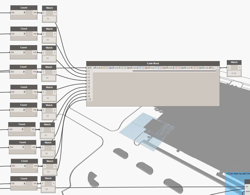

Is there a better way to check to see if all the lists I am smashing together have the same amount of entries then the way I show below? I am just trying to build in some error checking.
Here’s one way. In your case, swap out the first Count
node for a List.Create
node to connect all of your count nodes. Your List.Create
node will need to connect to theList.Reduce
and second Count
node in the image:
