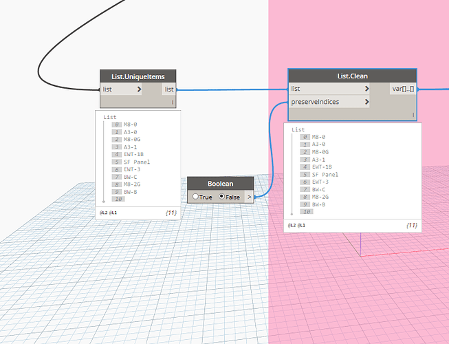

List.Clean not working even with "preserveIndices" set to false

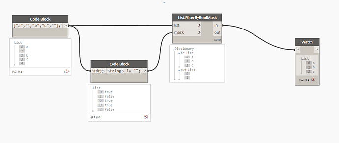

The node is working as intended. It is not supposed to clean empty strings ( "" ), which is the last input of your list.
Use this instead :

Or you can use List.Clean node in Orchid package.
Yes. Empty lists appear in the preview of the nodes as… well "Empty List" (see Alban’s post). You can still use my method to filter the empty strings if you don’t want them (using OotB nodes), or use Alban’s method (Orchid package) :slight_smile:
